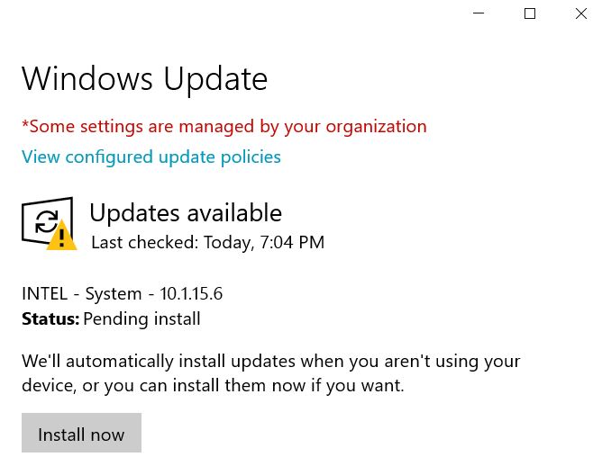

    Several days ago a Windows Driver (Intel – System 10.1.15.6) showed up in wushowhide. I hid it and then checked to be sure it was hidden.
    Then yesterday, the same update appeared on the WU screen with a “Download” button. (I have GP set to 2, notify download/install). I checked wushowhide and it was both in “Hide updates” and “Show hidden updates”. I tried several times to hide it in “Hide updates”, and it would report that it was fixed.

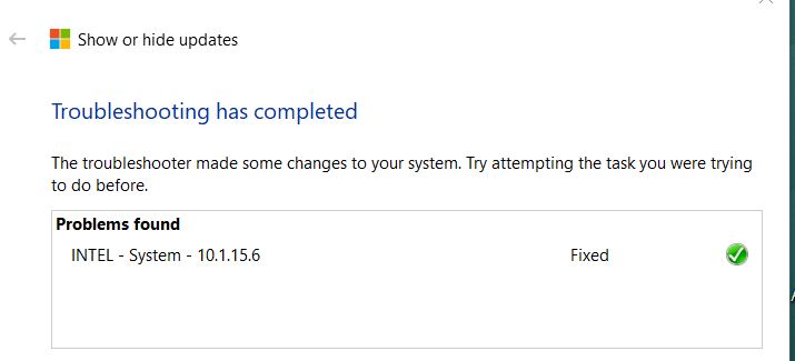

    But, when I checked wushowhide immediately after, it was still there, both in “Hide updates” and “Show hidden updates”.
    both-hide-and-hidden

    3. Opened wushowhide. Hid the driver. Got the “is fixed screen”, as I did before. Checked “Show hidden updates”; the driver was still hidden (as it was yesterday and several days ago). Checked “Hide updates.” The driver was still there (as it was several days ago). No matter how many times I did this, the driver was both in “Hide updates” and “Show hidden updates”.

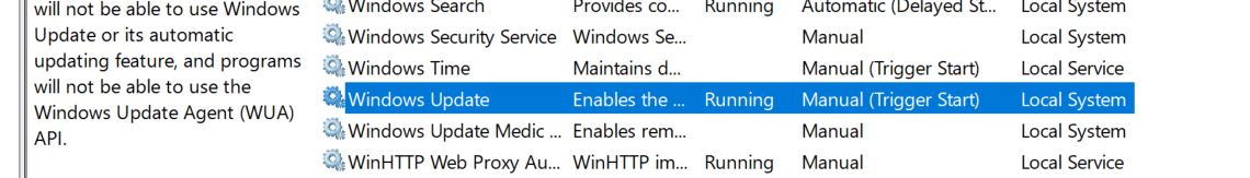

    4. Opened services. Applied Stop
    5. RESTARTED the computer. Checked to see that metered connections was still on.
    6. Opened Services and set to Manual. (It said Manual (Trigger Start).
    services_WU_Manual_Trigger-Start
    7. I immediately ran wushowhide. “Hide updates” looked as it did before. “Show hidden updates” looked the same as it was before, i.e., the driver was in both screens.
    8. I RESTARTED the computer.
    9. I opened Windows Update. This is the screen I got then
    10. And this is the screen I have now.
    schedule-restart
    Apparently, the steps in AKB2000013 did not work. Is there anything I can do right now to stop it? (Metered connections is still on).

    • #2310212
      I rather think this update is installed.
      Have you tried rebooting? If your system reboots without error, I would leave the update and any attempted removal alone.
      Do you have a backup?

        I don’t think it has installed yet, because I haven’t restarted yet.

    • #2310213
      This screen (Windows Update Screen B.jpg) for step 9 did not post. Here it is. It is the screen that I got before it changed to the screen in step 10. (schedule restart.jpg)
      Windows-Update-Screen-B
    • #2310217
      The update is pending,
      Run Disk Cleanup and Clean up system files.
      Then try WUMgr to hide the update:
      https://github.com/DavidXanatos/wumgr
