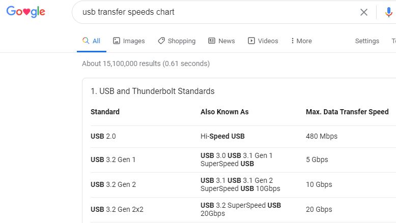

    • #2242169
      USB-speeds
    • #2242270
