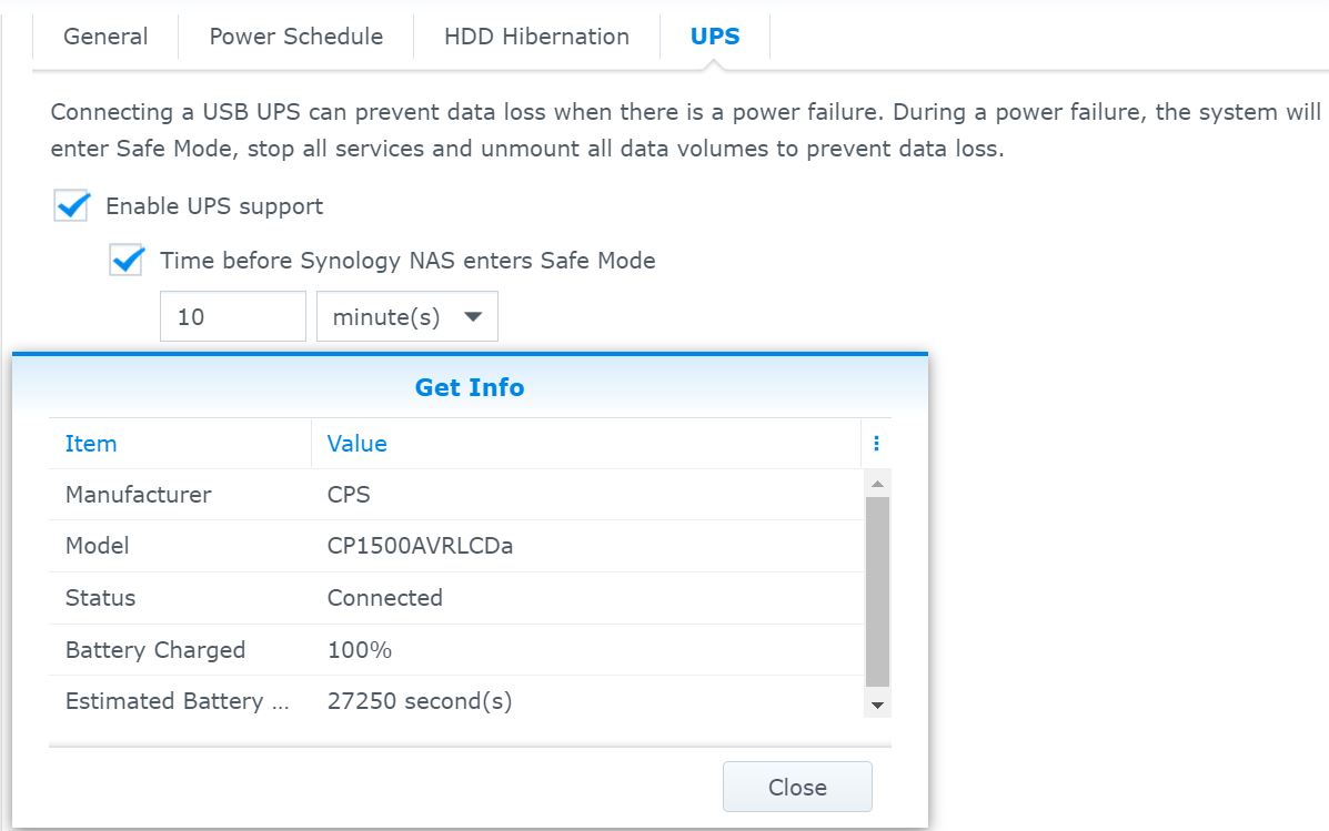

      Hey Y’all,
      The latest feature I’ve discovered is the ability to have your disks and/or the entire NAS power down after a set period of inactivity saving both energy and wear and tear on the drives. Of course this comes with WOL (wake on lan) so it will power up automatically when you need access, with the attendant lag of course. You can also set it to power the entire unit down and then turn it on again on your schedule. I set it for midnight and 7:00am, no need to have it running when I’m sleeping. Of course I’ll have to remember to reset this when we travel to allow for different time zones.
      Along with these power saving features it allows you to connect it to a UPS via USB and have the UPS shut the NAS down when the UPS battery is running low or a specified amount of time after MAINS power is lost. When setting it up it even had a drop down with all the main UPS vendors for you to select from so it knows how to setup the interface.
      SynologyUPS
      Chris had it right the capabilities are massive.
