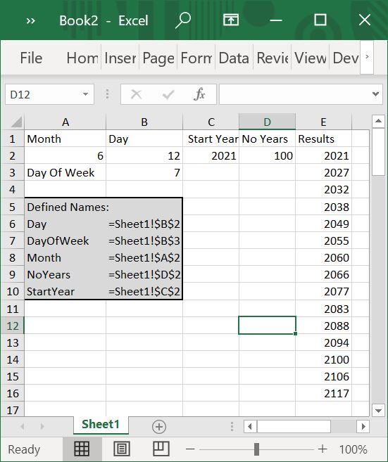

      Here’s some VBA to do the deed.
      Option Explicit
      Sub FindDayofYear()
        Dim iStartYear As Integer
        Dim iMonth     As Integer
        Dim iDay       As Integer
        Dim iYearCnt   As Integer
        Dim iDayOfWeek As Integer
        Dim iCntr      As Integer
        Dim dteDate    As Date
        Dim iNextYr    As Integer
        iStartYear = Range("StartYear")
        iMonth = Range("Month")
        iDay = Range("Day")
        iYearCnt = Range("NoYears")
        iDayOfWeek = Range("DayOfWeek")
        iNextYr = 2
        For iCntr = iStartYear To iStartYear + iYearCnt
          dteDate = DateSerial(iCntr, iMonth, iDay)
          '*** Change 7 (saturday) to any other number to find diff day.
          If (Weekday(dteDate) = iDayOfWeek) Then
            Cells(iNextYr, "E") = iCntr
            iNextYr = iNextYr + 1
          End If
        Next iCntr
      End Sub 'FindDayofYear
      DayOfYear
      HTH 😎
      • #2373842
        I like it 👍 … & now I don’t have to roll my own to keep in my tool box
