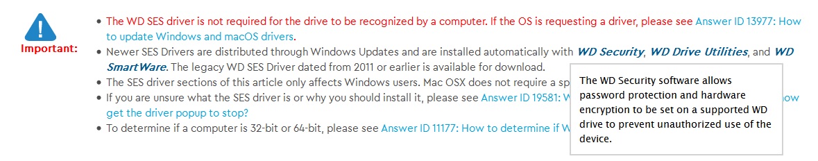

            satrow
            WD (and probably others) do use special adapters for many of their ext. drives, some of those drives also include encryption (was auto-installed by default on some WD drives, as was compression = nightmarish if ‘something’ goes wrong), eg: https://support-en.wd.com/app/answers/detail/a_id/16157
            WD-SES
