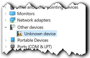

      Try this: *Right*-click on Start and select Device Manager from the list.
      Do you see something like this?
      unknown_device

      It is a Lenovo ThinkStation E32 – 30A1A005AU – MT-M 30A1 – A005AU Desktop, and it might be an Australian “special release” which may be why it is different to the Lenovo site.
      The Device Manager listing only shows the ASIX AX88179 USB 3.0 Gigabit Ethernet Adapter for the dongle – as I have said, the motherboard Ethernet has not worked since day-1, so that would explain the absence of a Realtek driver.
      The only Realtek driver in the Device Manager listing is for the card reader (SD and memory card readers/slots).
      2021-11-26-Device-Manager-Network-Adapters
      This is what I see.
      Megan in Sydney, Australia

        You are correct, in that your PC is, indeed, made for Australia. Since Rick couldn’t find much about it on Lenovo’s site for the UK, and I couldn’t find a thing about it on the U.S. part of the Lenovo site, I modified the URL a bit for Australia (pcsupport.lenovo.com/au/en…) and got results. The link below is for the drivers and software download page for your computer. Once you’re there, feel free to input your machine’s exact serial number in the box that says “Enter Serial Number” under the image of your machine, OR feel free to click on the links for the item you’re looking for a driver for, and you’ll be shown a list of applicable drivers or software for that item.
        https://pcsupport.lenovo.com/au/en/products/workstations/thinkstation-e-series-workstations/thinkstation-e32/downloads/driver-list/
        Because there are many drivers for the 64 bit version of Windows 10 (x64) but fewer drivers for the 32 bit version of Windows 10, please make absolutely sure that your machine has a 64 bit version of Windows 10 and not a 32 bit (x86) version. This can also make a big difference in the drivers either working or not working as well.
        When you first go to the page, it will default to showing you only 32 bit drivers. If you do indeed have a 64 bit version of Windows, then you’ll need to click on the blue link labeled “Select Additional OS ˅” (that last character is a blue-colored “down arrow”) and then select “Windows”>”Windows 10 (64-bit)” from the resulting list with check boxes.
        Per your screenshot above from Device Manager, you have an Intel brand Ethernet adapter in your system, not a Realtek brand Ethernet adapter. Getting the correct driver for your Intel I217-LM Ethernet port will very likely enable you to use it without having to resort to using the USB to Ethernet dongle, which may uncomplicate things for you.
        I hope this helps a bit.

      19) I then used the Network Connections to try and change the Automatic detection of IP addresses to a static address (192.168.0.54) and change the DNS Server to 8.8.8.8/8.8.4.4 (Google DNS). The DNS change took but I have an error on the IPv4 address that I input.
      20) As the ThinkDesk connects to the internet through a Netgear 16-port switch (IP 192.168.0.239), I’m pretty sure that this is not a problem…
    • #2407781
      Hi Everyone – as I am still unable to get the desktop to connect to the Internet (after 3 weeks of fiddling with suggestions from the internet!), I guess it is a signal to get a new desktop machine.
      Thank you to everyone who has made suggestions to try and help me.
      Merry Christmas and a very much happier New Year 2022!
    • #2407904
      A USB Wifi adapter can be purchased for around $20 in US and could be an easy fix.  Get or use a usb extension cord to allow moving it to best location for signal.
    • #2409693
      There is a small possibility that Windows is updating the driver for your Ethernet port when it does a Windows update, and that the driver you end up with doesn’t work with your Ethernet port.
      I suggest disabling automatic driver updates, so that this doesn’t happen in the future:
      * Type “GP” in the search box (without the quotes). “Edit Group Policy” will appear in the above list. Run it.
      * Drill down as follows:
      –> Computer Configuration
      –> Administrative Templates
      –> Windows Components
      –> Windows Update
      * Right-click on “Do not include drivers with Windows Updates” and choose “Edit”. Choose “Enabled” and click “OK”.
      * Exit Group Policy Editor.
      You can always do a manual driver update if one is needed; no need to let Windows do it automatically.
