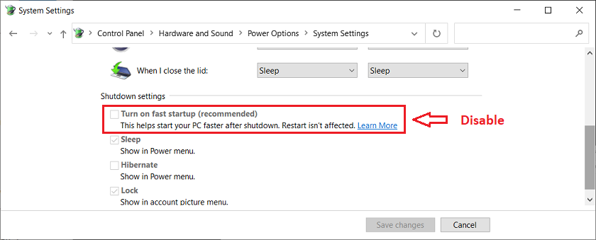

      Someone on another forum suggested I disable fast startup.  That might be the answer since the intermittent blue screen ONLY happens immediately on startup.  Perhaps in this case the problem is that some software is starting too soon and dependencies between software is causing the problem?  I’ll see what happens over the next few weeks.
      David
      • #2519536
        Someone on another forum suggested I disable fast startup. That might be the answer since the intermittent blue screen ONLY happens immediately on startup…
        Hi edsel1924
        That sounds like good advice, even if it doesn’t fix your intermittent Blue Screens. I normally recommend that Win 8.x or higher users disable the Fast Startup power option in Control Panel | Power Options | Choose What the Power Buttons Do | Shutdown Settings as instructed in Brink’s TenForums tutorial How to Turn On or Off Fast Startup in Windows 10. Fast Startup is enabled by default in Windows 10 but this power option (also known as hybrid boot-up / hybrid shutdown) can interfere with the loading of services and drivers of third-party software at boot-up and cause all sorts of odd glitches and unexpected problems.  Microsoft has acknowledged that Fast Startup can even interfere with Windows Update under certain circumstances  – see the MS support article Updates May Not Be Installed With Fast Startup in Windows 10.
        Win-10-v21H2-Control-Panel-Power-Options-Turn-Off-Fast-Startup-EDITED-08-Nov-2022
        Dell Inspiron 5584 * 64-bit Win 10 Pro v22H2 build 19045.2364 * Firefox v108.0.2 * Microsoft Defender v4.18.2211.5-1.1.19900.2 * Malwarebytes Premium v4.5.19.229-1.0.1860 * Macrium Reflect Free v8.0.7175 * Inspiron 5583/5584 BIOS v1.21.0
    • #2520247
      I always turn Fast Start off if I have an SSD. The disk makes start so fast that I don’t need the potential problems that FS may cause.
