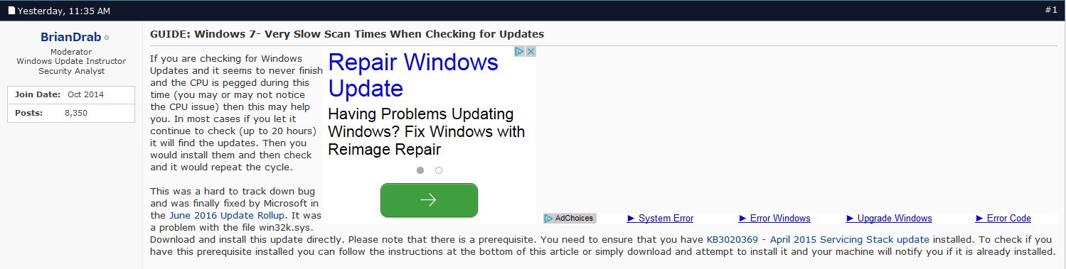

      There’s also a new guide on Sysnative today: GUIDE: Windows 7- Very Slow Scan Times When Checking for Updates
      In one instance, after installing the update, checking for updates finished in 19 seconds vs 18 hours that it used to.

      That’s the second time I’ve clicked on a Sysnative link where all of the text is bunched up in a single wrap around column down the left side of the page.
      Not sure if it was another one of yours, Andy.
      I’m sure I’ve seen someone else on the forum complaining of similar on other websites, but can’t remember if they found the cause.
    • #1569573
      Could you be seeing the effect of a partial ad removal?
      44916-SysnativeAds
      I use HostsMan (MVPs, hpHosts +partial +Ad & tracking, Malware domain, FB, YT) plus uBlock Original (all except Experimental. + Adblock Warning Removal, Anti-Adblock Killer, Peter Lowe’s Ad server and Basic Tracking and Malvertising filters by Disconnect), so I had to make a few clicks to see it that way 😉
      • #1569610

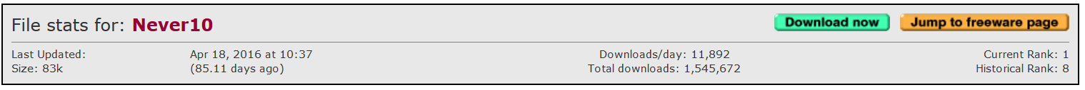

      Still, rgrosz (and Paul), I followed the Never10 link but cannot figure out how to get the utility to work. I’m obviously missing something.
      Can you help me understand how to get this utility…just in case I ever get WU to give me updates! If I have it, then I can select “download automatically” and that might let things happen…without allowing Win10 to sneak in.
      Thanks,
      Linda
        When you download the EXE file, just click on the file to run it. It only takes a few seconds to change your “Windows 10 update” setting – just click the button at the bottom of the screen.

      P.S. for Rick:well, duh, I’d missed the green Download button (see attached) when I scanned quickly down the page. Once that was clicked, it was easy!
