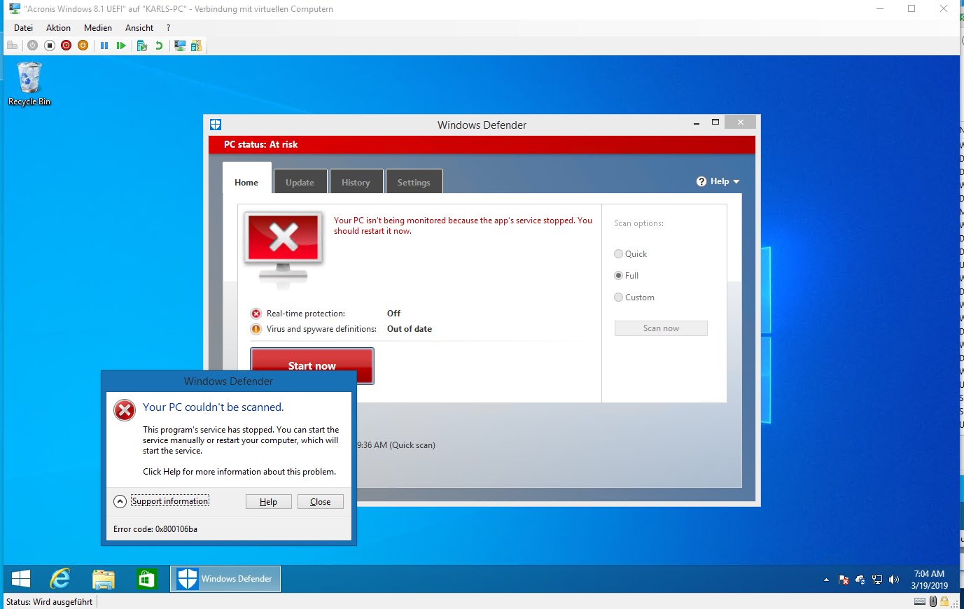

      Hi everyone,
      so all my findings in a summary.
      Definition version for all OS: 1.289.15121.0
      Errorcode: 0x800106ba
      Affected OS:
      Windows 7
      Windows 8.0
      Windows 8.1
      All share same error code but will fail at different spots / time during scan.

    • #343128
      I have Windows 8.1. Windows Defender is stopping. This isn’t a VM, but rather a home machine. At first I thought I had something that was breaking it. But Malwarebytes still worked fine. I even did a refresh of Windows just to be sure. Windows Defender still stops. It says the “process has stopped working.” But glad to see I’m not the only one having this issue.
      UPDATE:
      Windows Defender will start scanning like normal but then it says the process stopped working and I have to turn Windows Defender back on again.

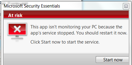

      Can confirm that my Microsoft Security Essentials is also failing.  I was about to panic and do a full reinstall of the program, but something possessed me to look here.
      Definition version is 1.289.1521.0 on Windows 7 Ultimate x64

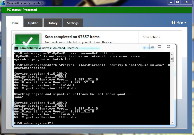

      In both the Win 7 SP1 x64 and Win XP SP3 x86 environments I was able to roll back MS Security Essentials using System Restore to the previous definitions.
      Win XP was then able to complete a scan without issue.
      Unfortunately, on the Win 7 test I hadn’t unticked “check for the latest definitions” so when I forced a manual scan it appears to have uploaded the faulty definitions. I need to roll back system restore again with that unchecked.
      Bottom line is avoid this definition update.
    • #343208
      I just came to the lounge to kvetch about Microsoft Security Essentials going kerflooey and I see you beat me to it. Bless you!
      It keeps giving me a message that my PC is at risk and warns me to start the program. I click start, it starts, and then back to red alert again. I tried rebooting but that didn’t help.
      Could it be because I didn’t install the March updates?
      Anything to do but wait?
      Thank you.
      MSE-stopped

    • #343283
      1512  is an older update from 3/18 but does work without error.
      On Windows 7 open CMD as Admin and do:
      “C:Program FilesMicrosoft Security ClientMpCmdRun.exe” MpCmdRun.exe -RemoveDefinitions
      It should show 1512 or older as the signature rollback. If you removed MSE already trying to fix this you won’t have older definitions so do:
      “C:Program FilesMicrosoft Security ClientMpCmdRun.exe” MpCmdRun.exe -RemoveDefinitions -All
      Then download the 1.289.1512.0 definition here:
      https://www.catalog.update.microsoft.com/Search.aspx?q=security%20essentials
      MSE

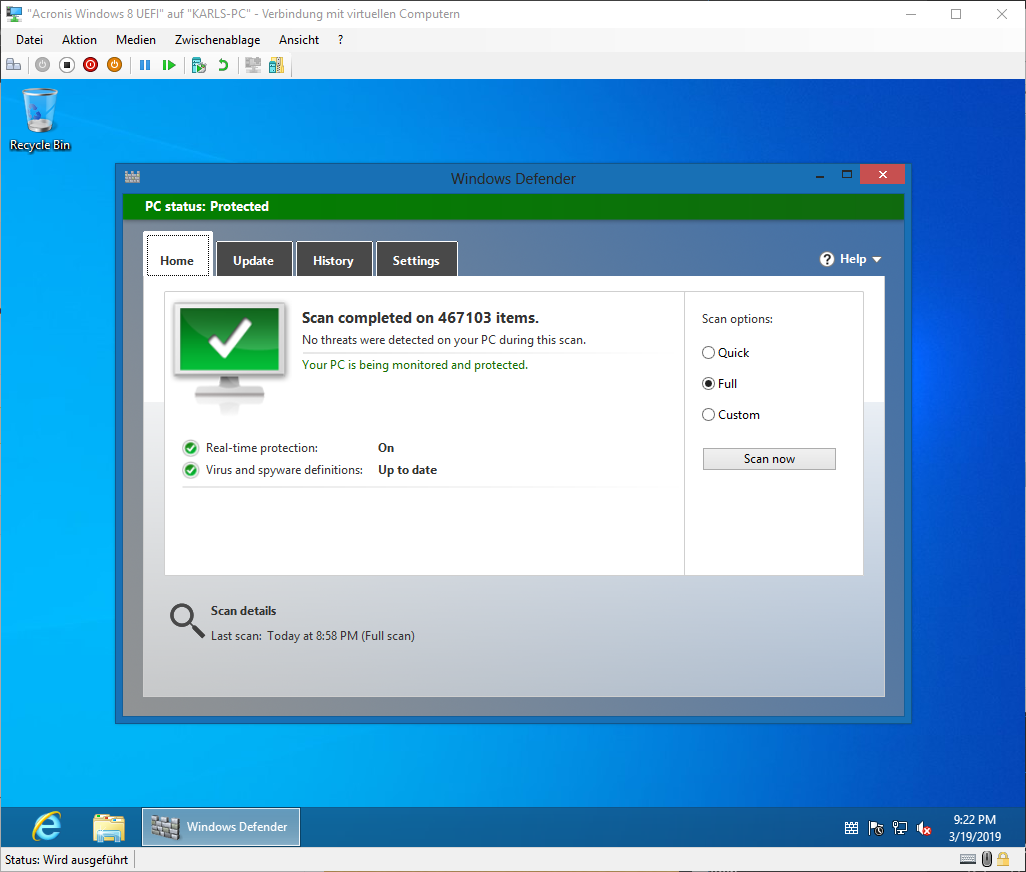

    • #343403
      Good news the issue is fixed
      tested on
      Windows 7 SP1 CU 2019-03
      Windows 8.0 CU 2019-03
      Windows 8.1 Update 1 CU 2019-03
      Defender Definitions: 1.289.1587.0
      Thanks @maryjofoley and the @WD
      win7.0_fix
      win8.0_fix
      win8.1_fix
      win8.0_definitions
