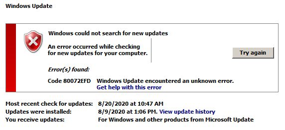

    My Windows 7 Windows Update stopped (or seemed to stop) its daily check for updates.  Aug. 20, 2020 was the last date it shows a successful check. My WU is set on “Check for updates but do not download or install them.”  So I tried manually clicking on “Check for Updates” and got an error message with this error code:  80072EFD.
    I’ve got 8 Office 2010 updates waiting on my WU that came in earlier, and will eventually want to download and install them. WU is probably trying to check, but failing every time.  Below are some snips of what I’m seeing.  To my knowledge there’s nothing I’ve done to cause WU to be blocked.
    Has anyone else had this happen or possibly know what’s going on?  This is the first time I’ve had any problem with my Win 7 Windows Update in a long time.
    WU-1
    WU-2
    WU-3

    • #2290955
      Hi Charlie,
      Out of curiosity have you clicked the link on 8/9/2020 View update history  to see if anything got broken or didn’t update properly?  (This might need a deeper dive)
      WU-2.2
      Also, what anti-virus / firewall are you using?
      Your AV might have gotten updated around the 9th and doesn’t know to let windows update.  That happened to me with Avast.
      Good luck with that.  Maybe someone who knows more than me will have an answer.
      Gary

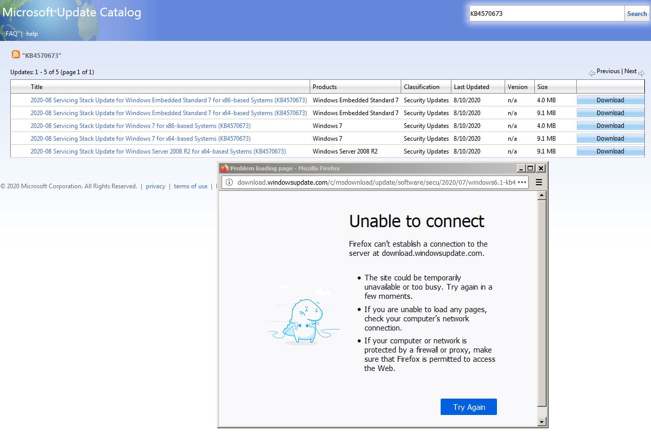

          You’re saying you can’t get to https://www.catalog.update.microsoft.com/Search.aspx?q=4570673? I had no difficulties. Perhaps you hit some kind of a transient glitch.
          • #2292099
            Yes I can get on to the catalog, it’s when I try to download something that I get a Not Able To Connect page.
            Have you seen the price of Tums? It's enough to give you heartburn.

      Tried using IE 11 to access the MS Catalog, tried using the fix, nothing seems to work.
      MS-download
      • This reply was modified 3 years, 3 months ago by Charlie.
    • #2291682
      Tried that already, experimenting to see if I could get latest SS 4570673, here’s the result –
      MS-wont-reply

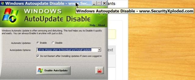

    • #2296071
      Here is one thing I use to make Windows Update operations pretty hassle-free:
      http://www.SecurityXploded.com – Windows Update Disable [it enables it also]
      It takes a little bit getting used to, because the menu you see offers you what choice you can do next, it does not show what choice you have made.WindowsUpdateDisAble
