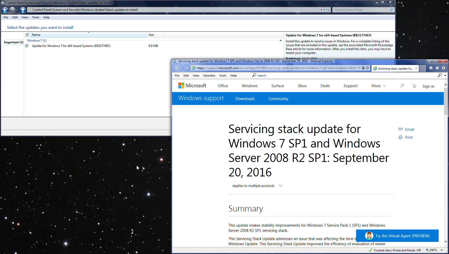

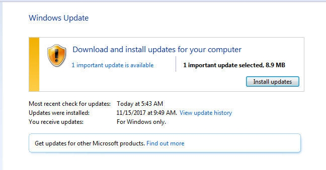

        Noel Carboni
        Do any of the messages people are seeing here state WHICH service is not running? I ask because Windows Update requires several services to do its work. The information might be available in the event logs.
        FYI, I have several Win 7 systems that got their updates around the middle of November. One is a test VM that I can easily snapshot and revert as needed. I just reconfigured the firewall to allow updates (normally the system can’t reach the servers), started the Windows Update service on it (I normally keep it disabled), and saw this sequence.
        WU1
        WU2
        WU3
        WU4
        The only thing I didn’t have from the November update set, probably because of the timing of when I ran the update, was the the “Servicing Stack Update” (dated September 20, 2016!?!).
        Not sure if this helps identify what’s wrong, but it’s a data point. Any suggestions for the next thing(s) I can test here?
