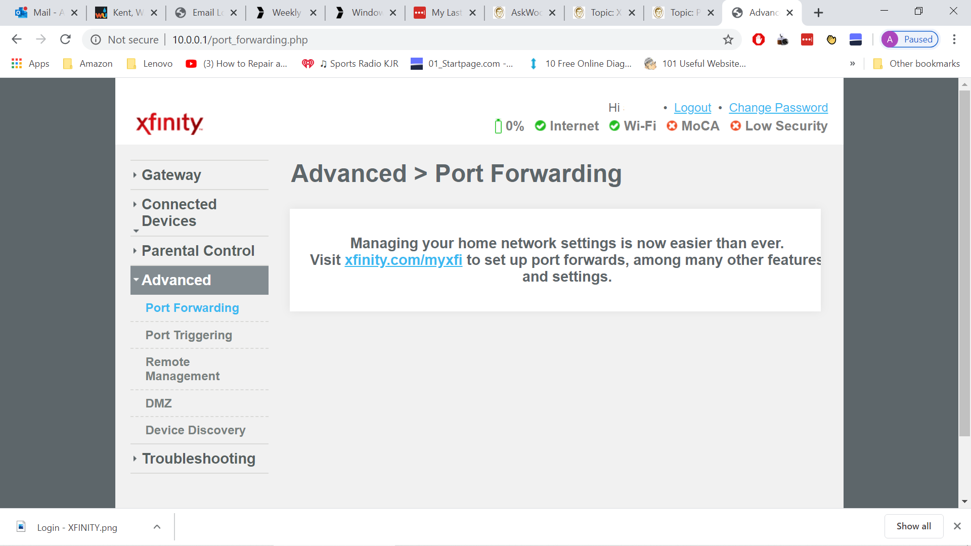

        I plugged it in, turned it on, went through the configuration process, found a way around not having enough Ethernet ports, and was ready to fly.  One of my applications requires a port forwarding entry.  So imagine my surprise when I attempted to create a port forward on the router and it just gave me a link that said “You have to go to the xfinity.com website to create port forwarding entries”!  Worse than that, when I got to their website, where the menu item was supposed to be for port forwarding, there was nothing!

        Five minutes later I was absolutely horrified when I went back to where the Port Forwarding section of the router had been and was confronted with that same nasty notice that I had to go to Xfinity.com to manage Port Forwarding!  It had been local a minute ago, but somehow they managed to hijack it again, even on my personal router!  Even worse, when I got to the xfinity website, I got a nastygram telling me that I couldn’t do that, I would have to upgrade my equipment!  Presumably to one of their own routers!
        So shorten an already long story, the solution was I had to reset the new router to factory settings.  Then I couldn’t connect to it via DHCP, so I had to hard-code an IP address on my PC.  Then I created a port Forward (which was back to its normal local configuration status).  THEN I reconnected to Xfinity (which also took an act of Congress).

        We have an older Comcast/Xfinity dual-band router/gateway which is actually an ARRIS TG1682G. It came with the apartment where we live. The first screenshot below shows the message displayed when I click on Advanced Settings / Port Forwarding. The second screenshot shows the next page after I click on ‘Continue”., and so on.
        **Caveat**: Our apartment building has a Comcast “Bulk” account. The owners then offer internet, or cable TV, or both for a charge added to the monthly rent. Because of this and the fact that it’s an older router one might think there would be few user-adjustable options, yet port forwarding and several other settings are indeed available as you can see:

        Yeah, my original problem was that when I went to xfinity.com to get into the advanced settings and access the port forwarding, none of those settings were even on the option list!  Just some BS informational setting!  Their tech support, after an hour and a half, basically gave up on it and said “they’d get back to me”.
