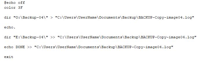

AskWoody PlusSure. I cut it down to the relevant lines:
@echo off
color 3Fdir “O:Backup-04” > “C:\Users\UserName\Documents\Backup\BACKUP-Copy-image04.log”
echo.
dir “E:Backup-04” >> “C:\Users\\UserNameDocuments\Backup\BACKUP-Copy-image04.log”
echo DONE >> “C:\Users\UserName\Documents\Backup\BACKUP-Copy-image04.log”
exit
The O: drive is the attached external USB drive.
The E: drive is the network share.

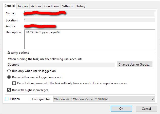

I ran this batch file manually from the local drive and both directories are listed properly. When I run the program from Task Scheduler only the O: drive is listed after it has completed.

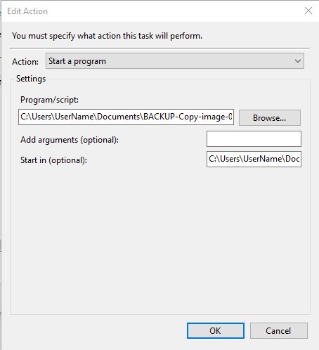

I’ve attached a couple screen grabs of the Task Scheduler windows.

AskWoody PlusThank you all for your suggestions. I did not include quote marks in the Start In box and I disabled Run with highest privileges and I tried using the full UNC for the shared drive. All to no avail. Directory listing is still missing in the log file.
Task Manager has a lot of little gotchas. Still no joy.

AskWoody PlusI knew that would be the next question and I should have included that information. I do have the path to the location of the batch file specified in the Start In box (C:\Users\username\Documents\backup_batch_file_location\).
