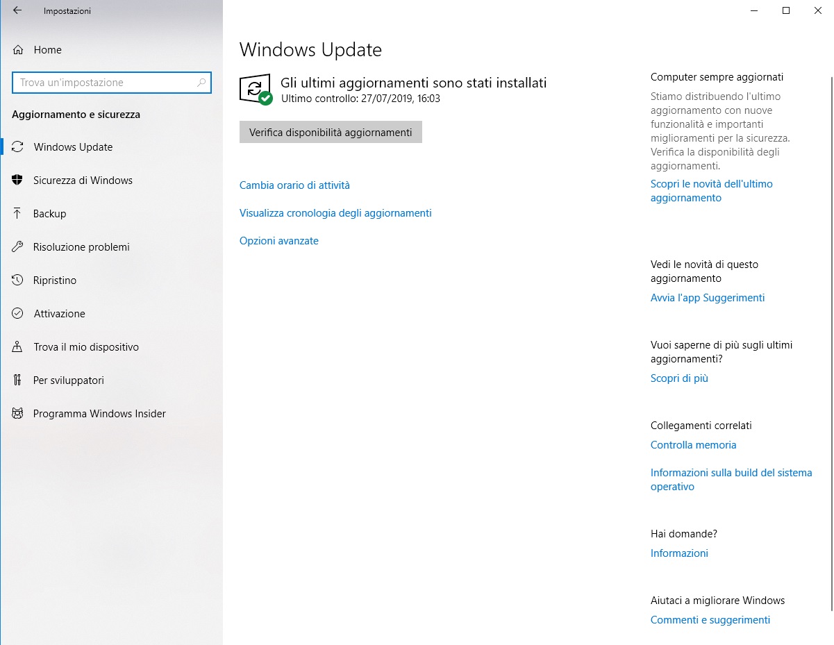

AskWoody LoungerAugust 1, 2019 at 12:32 pm in reply to: First report of a Win10 Home 1803-to-1903 pushed upgrade over a metered connection #1900441Thanks PKCano. I plan to hang on to the metered connection and keep my fingers crossed. No download of 1903 took place on the metered connection so far, but I’m not too happy sitting here just waiting for it to potentially happen. I’m actually wondering whether to avoid this uncertainty I should upgrade to 1809 using the copy I downloaded back when that was suggested.
What is really interesting, however, is that today my Windows Update screen changed back to the “All available updates installed” and it is no longer reporting the Feature Update to 1903 being pending for download:
I did not take any further steps after yesterday’s notice about the pending download (except running wushowhide which reported nothing available to hide). Also, the “last checked” date did not change. It almost looks like WU tried to push 1903, failed because the connection is set to metered, then on the subsequent reboot realized that I hid the 1903 Feature Update in wushowhide. Does this sound possible?

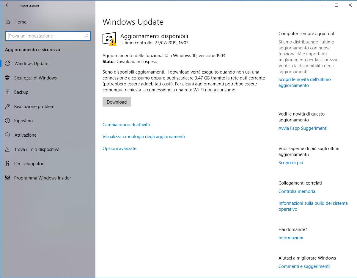

AskWoody LoungerJuly 31, 2019 at 3:01 pm in reply to: First report of a Win10 Home 1803-to-1903 pushed upgrade over a metered connection #1899473Using wushowhide on July 27 I spotted on my Windows 10 Home 1803 computer the Feature Update to 1903: I promptly hid it in wushowhide, checked that it was hidden and followed the “How to clear the Windows Update queue in Win10” instructions from PKCano. After that, the Windows Update screen reported that all available updates were installed and that the last check had been performed on July 27 around 4 pm.
Today I was surprised to receive a notification that an “update cannot be installed”, so I looked in Windows Update and found the following:
It’s not in English (apologies), but it’s saying that the last check dates back to July 27 at around 4 pm (i.e. the same date when it previously reported no updated being available), but now it is reporting that the Feature Update to 1903 is pending, but cannot be downloaded due to my ethernet connection being set to metered.
I find this extremely annoying and suspicious, since it looks like hiding Feature Update to 1903 in wushowhide was not enough to really hide the update.
