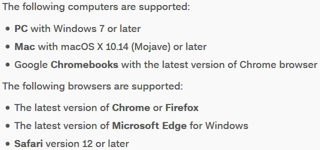

AskWoody MVPYeah, that’s what I figure.
Strange thing is, I compared the computer section of the “current” CNN supported devices page with the Wayback Archives snapshot from Jan 01 2023 at 03:27:38 and they’re both exactly the same!
And while it doesn’t specifically mention Firefox ESR, Seamonkey did always give me the desktop version until their April 19th “site refresh“.
I’m guessing whoever programed the code for the refresh started using commands from some module that’s not part of the older ESR browser.
