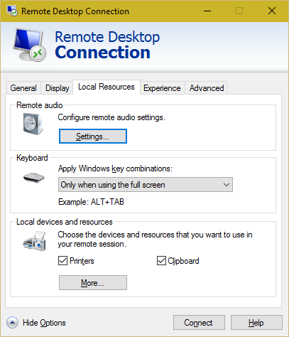

AskWoody LoungerApril 21, 2016 at 10:16 am in reply to: Windows 10 resets default printer after RDP session #1560985I don’t want to contradict you bbearen, but it is a problem for us. It’s true, if I can remember to always remember to deselect ‘Printers’ when I RDP, it won’t be a problem. I understand what you suggested, but it causes a real problem with Microsoft Access. We use Microsoft Access for our database, and unless you go in to each report and manually set a printer to be used all the time, Access goes with the default printer. When a report is set to print on a Letter sized piece of paper and suddenly you are trying to print to a label, it causes problems.
I have yet to see any benefit in this new option MS placed in W10.

AskWoody LoungerFebruary 25, 2016 at 12:06 pm in reply to: Windows 10 resets default printer after RDP session #1553482I’m experimenting with that, JoeP517. Thank you for that suggestion. So far that seems to have made a difference. For anyone reading this, I understood that when you remote in to another computer, if you do not need the printers, before making the connection, go to Remote Desktop Connections –>Local Resources and clear the check box by Printers.

AskWoody LoungerI spoke too soon. The previous option, allowed me to ‘Preview’ the report the way it was supposed to look, but when I would print, it still would print with the other printer margins and I could find nothing to change that. I finally had to make a whole new report, now it works correctly.

AskWoody LoungerOK, here’s an update. After doing some more “Google’s my friend” research, I changed the driver to the printer and it works fine. It makes absolutely no sense to me why only 1 report was causing this issue. For now the issue is fixed!
