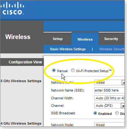

The easiest way to disable WPS is the direct route — in the router’s configuration menu (see Figure 1). Although most current routers support this method, many popular older routers don’t.
Figure 1. This Cisco/Linksys router-configuration page has a seemingly easy way to turn WPS off.
Shockingly, selecting the option to disable WPS on some routers doesn’t actually do anything! The configuration screen might say that WPS is disabled, but it actually isn’t. (I’ll also come back to this in a moment.)
