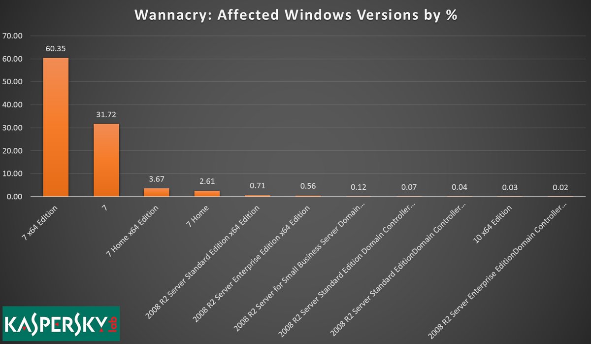

    This is the part that gets me. WannaCry only infects Windows 7 machines. Period. (And Server 2008R2, which is basically Windows 7.)
    WannaCry does NOT infect Windows XP. I’ve been saying that since my first report a week ago. In spite of what you’ve read, WannaCry does not infect WinXP.
    WannaCry does NOT infect Windows 8.1.
    WannaCry does NOT infect Windows 10. Any version. That tiny blip on the Kaspersky chart is no doubt due to mis-reporting, or the possibility that people were running infected WinXP machines in a Virtual Machine on Windows 10. I don’t know of any other way there could be any occurrences.
    That said, you need to make sure your Windows computer is fully protected against WannaCry – every version, from XP to Win10. The problem isn’t WannaCry itself. The problem’s all the other malware that’s likely to follow in its footsteps.

    The Kaspersky graph shows a tiny, tiny number of Win10 machines infected. My guess is that’s either a false positive, or from people who were intentionally infecting Win7 machines running in a Virtual Machine on Win10.
    There’s a commenter (I know, I shouldn’t read the comments) who says:
    You want to know why Windows 10 was on the list?
    I blame Microsoft for still allowing people to opt-out of auto-updates. The mass do not always know what’s best for them, so it is our responsibility to firmly reject their demand when it’s harmful, and educate them why so.
    I could pull my hair out. Win10 wasn’t directly affected. Opting in or out of updates isn’t a problem – although if you opted out of Win7 auto updates and you didn’t check for two months, yep, you could’ve gotten stung. But Win10? Puh-lease.
