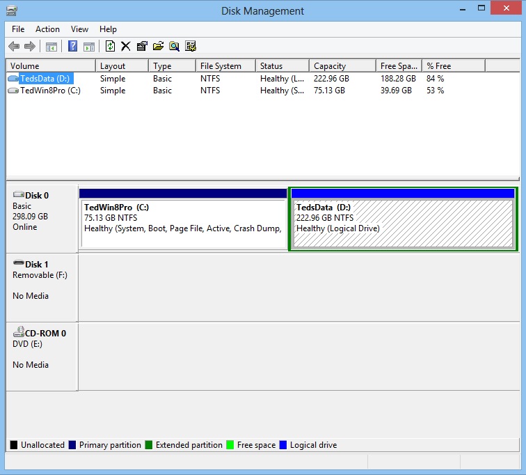

    • #1394039
      Hi JP,
      Can you post an image of ‘Disk Management’ 33324-Make-an-Image-and-post-it
      I make a folder on my external hdd named as the date i.e. May 26. I then do a ‘One Click’ back-up with Acronis to that folder, a ‘Systemback-up’ is created including the MBR.

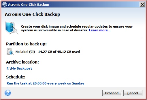

    • #1394073
      Hi JP,
      Your image is as it should be.
      In my image, click the link below Archive location to set your location.
      Click the link below Schedule to set it.
      All my back-ups & restores are done within Windows. i.e. not using the Recovery disk.
      34062-RR1
      Click image to enlarge it.

      Did you try looking at the system reserved partition with Protected operating system files view enabled (unchecked)?
      If you want to avoid any little reserved partition being used you need to format the drive with GParted perhaps or with another system first, and then not let Win 7 touch the partitioning or do any formatting at the time of install.
    • #1394243
      Jean,
      You can Image any or all the partitions on your HD, then Restore any partition, or the entire HD, you choose.
      I doubt you need to ever restore the system reserved partition, unless your entire HD is fried in which case the entire HD would need to be restore.
      In my case I used to have 3 partitions, Win 7, Win 8 and a data partition. I could Images all 3 at once, creating a single Image file, then restore any of the 3 singly simply by choosing which to restore, and where to restore it. Note however that it is vital to have each partition labeled correctly to make then easy to distinguish one from the other.
      In DrWho’s example, you always want to store your Image away from the main HD because the reason you may need to restore is because the HD fried. If your Image is on a separate partition on the same HD, you will loose your Image at the same time you loose the HD. Also make sure you do create the Boot Media from what ever app you use because this is what you will use to boot when your PC will not boot.

      Jean,
      After reading the article just referenced, I’m a little confused as well, LOL
      In my case, I previously (in Win 7) I had removed this partition using a 3rd party partitioning app to delete it thus created unallocated space. My PC would not boot. I then had to use a command prompt to fix the MBR which, I believe, placed the MBR on the main Windows partition. This articleshows the steps necessary to fix the MBR.
      Once this was done so I could again boot into Windows, I then used the 3rd party partitioning app to move the C drive forward into the unallocated space. Now I had just one partition that included the MBR. Now when I upgraded to Win 8 I used the Custom Install, and Win 8 also included the boot info on the C Drive. If I look at my Disk Manager there is no system reserved partition listed.
      34078-DiskManager
      I believe everything I state here is correct. I however am not a hardware or Windows engineer so perhaps I am not stating correctly how everything worked. All I know is it worked.

      I only use Acronis 2010’s ‘One Click’ method which gives a system image backup including the MBR. I have successfully done a ‘Restore’ using one of them to a larger new HDD, which in this case, must include the MBR to be added to the ‘Restore’.
