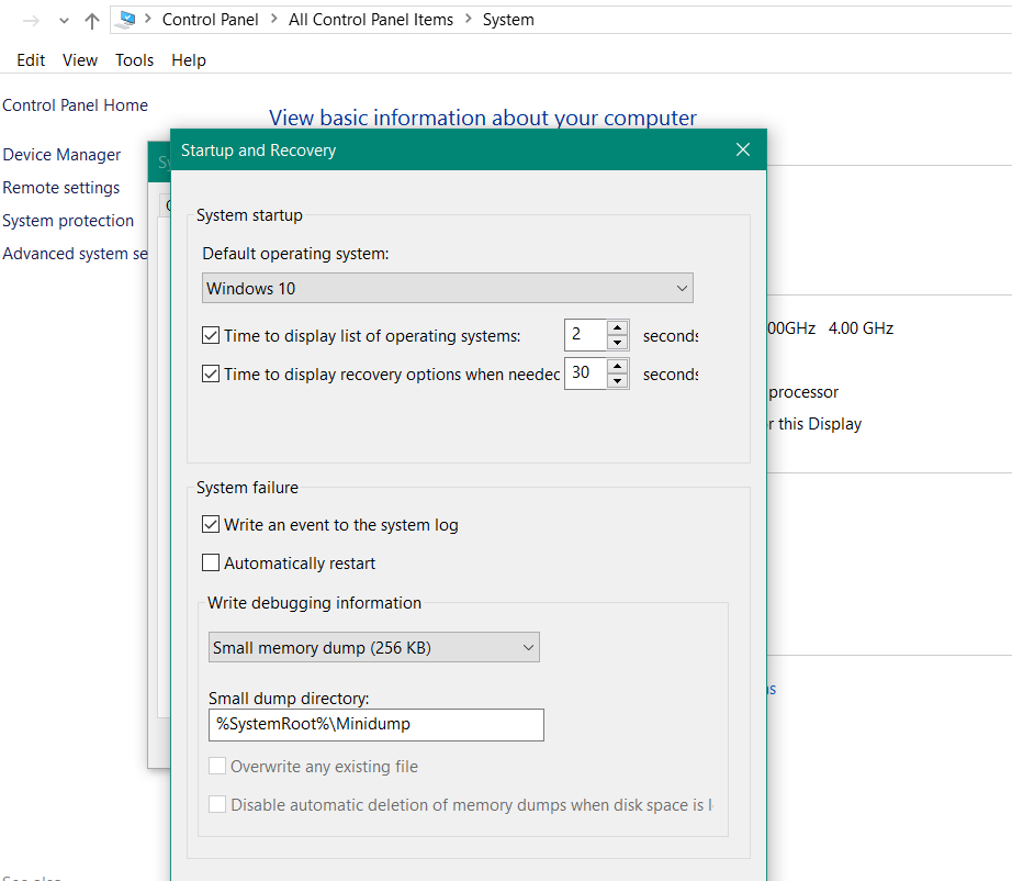

AskWoody PlusMarch 19, 2017 at 11:35 am #1593794If windows itself needs to shutdown you might want to check the auto restart setting as well as Bios/Uefi settings:46977-Capture:cheers:

AskWoody_MVPMarch 19, 2017 at 12:02 pm #1593796 -
wavy
AskWoody PlusMarch 19, 2017 at 12:41 pm #1593800I think that could only be relevant for a Windows failure, not a power failure.
At what stage after a power failure could Windows decide it should restart?
I am on unsure territory here buuut; if a brown out causes a windows corruption maaaybe it will decide to shut down.
If I am standing too far in left field please correct me!
:cheers:

AskWoody_MVPMarch 19, 2017 at 1:12 pm #1593801I am on unsure territory here buuut; if a brown out causes a windows corruption maaaybe it will decide to shut down.
:cheers:I suppose that’s a possibility. But I thought it would have been taken care of by a UPS, which is really required for proper shutdown and restart after a blackout.
