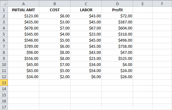

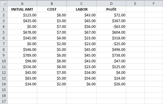

    • #1402847
      Beej,
      This code will look in a specified column for zeros then deletes the entire row. In this sample, the search is in column 1 but it can be changed to any column. The number of rows to search is automatically determined by finding the last row using values in column 1.
      HTH,
      Maud
      34470-deleterow1 34471-deleterow2
      Code:
      Public Sub DeleteRows()
      [COLOR=”#008000″]’DECLARE AND SET VARIABLES[/COLOR]
      Dim LastRow As Integer  [COLOR=”#008000″]’LAST ROW NUMBER[/COLOR]
      Dim ZeroCol As Integer  [COLOR=”#008000″]’COLUMN CHECKED FOR ZEROS[/COLOR]
      LastRow = ActiveSheet.Cells(Rows.Count, 1).End(xlUp).Row
      ZeroCol = 1  [COLOR=”#008000″]’CHANGE TO COLUMN TO BE CHECKED FOR ZEROS[/COLOR]
      [COLOR=”#008000″]’———————————————————
      ‘SEARCH ZEROCOL FOR “0” AND DELETE ENTIRE ROW[/COLOR]
      For I = 2 To LastRow  [COLOR=”#008000″]’START ROW 2 ALLOW FOR HEADER[/COLOR]
          If Cells(I, ZeroCol).Value = 0 Then
              Cells.Rows(I).EntireRow.Delete
          End If
      Next I
      End Sub
