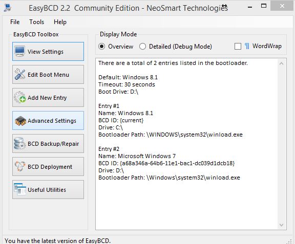

      I note that Device: unknown appears where I would expect a drive letter as it does in my dual boot system (see attached).
      36127-EasyBcd
      While booted in Windows 7 is there a listing of the Windows 8 drive in Explorer? Hopefully, this will help in trouble-shooting. Perhaps an administrator will offer more assistance after your results are posted.
      Rich
      • #1436192
        Rich, thanks for your reply.
        In your attachment the drive letter for Win 8.1 is D at the top of the Window, but C below that. Why is that? Also, do I change my entries in Easy BCD while booted in Win 7 or Win 8.1?
