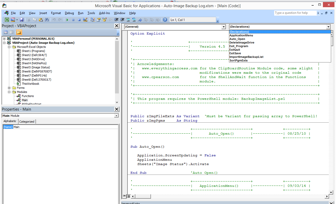

      Since most of your work in in VBA I’m sure you know about the dropdown that will get you a list of the functions in the current module, but just in case…
      43415-VBAVBE
      Between the dropdown and the Project Explorer on the left it’s pretty easy to navigate your VBA project and with the added use of BookMarks (as you can see I added the icons to my toolbar) it’s easy to mark places you are working on for easy return.

        Thanks RG, I do futz with the dropdown, even naming main Subs a1… a2… a3… etc to help with finding them. I’ll have to figure out the Project Explorer and BookMarks, I haven’t used them to advantage.
