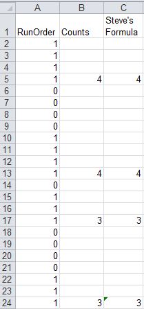

    Hello Everyone,
    I have a spreadsheet with column called “Runorder” with only 0 and 1 values. I want a count fuction to start when the value is 1 and end the count when value is zero and store the count value in a cell. Also the count fuction should start the count again and keep iterating it till end of data in the column.
    I am not very good with VBA coding and any help would be appreciated.

      I don’t think it needs VBA, just a formula. Where do you want the values stored? Could you attach sample file setup with the values desired?
      Steve
    • #1334833
      I’m sure Steve will come up with a better solution but here is some VBA to do the trick assuming you want the totals stored in the adjacent column at the end of the running 1’s. :cheers:

      31088-RunCounts

      With that type of setup, you can get the results with the formula in B2:
      =IF(AND(A2=1,A3=0),SUM(A$1:A2)-SUM(B$1:B1),””)
      Then copy it down the column…
      Steve
    • #1334925
      If only I could predict the stock market as well as I can predict Steve. 😆
      Nice job! If I could just learn to think like Steve. :cheers:
      31094-RunCountsSteve

      Thank you everyone for the quick help…Steve ur solution was very simple and ez as I dont have to work with VBA anymore 🙂
