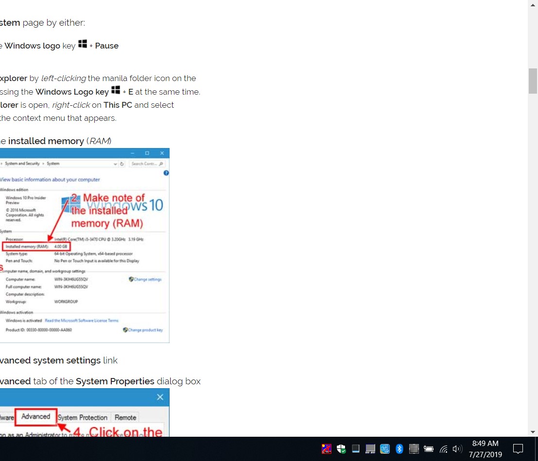

        Also doubled the height of the Taskbar to no avail. Before the Windows update, the Taskbar displayed Time and Date (day isn’t spelled out here but you get the idea):
        Time-date-both-displayed
