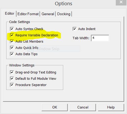

      Your 2010 probably has the “Require Variable Declaration” ( Optioin Expicit ) 37658-vbeoption checked in the VBE. Look at the top of your module and you’ll see it there.
      Just add: Dim dialogstyle as Integer
      That should get you going. HTH :cheers:

      That was not checked BUT… in planning for the future, I had placed “Option Explicit” in the code. Once I commented that out all seems to work just fine. Thanx SO much for pointing me in the right direction.

      Please consider checking that option and always declaring your variables. It makes finding things like incorrectly spelled variables much easier. True it is a little more painful up front to remember to add the declaration each time you need a new variable but in the long run it will be well worth it. As one of my old mentors used to point out “There is never enough time to do things right…but always enough time to fix them later”, he said dripping with sarcasm! :cheers:
