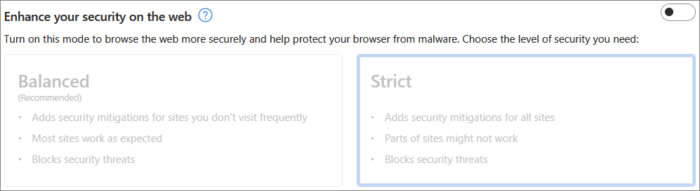

        So I tried it using 122.0.2365.59 and here’s the results.
        With the toggle OFF:
        SecurityToggleOff
        The settings under the toggle are grayed out can’t be changed.
        But with it ON:
        SecurityToggleOn
        They can be changed.
        So, like I said, the advice, “as given“, doesn’t make sense because it’s impossible to do it that way!
        The more reasonably advice would have been, “Select Balanced and then turn the toggle off.”
