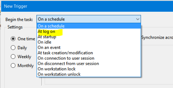

You can change the Triggers on the tasks from At Startup to At Logon. This should alleviate the problem.

Hi RetiredGeek,
Thanks for the information I was aware of that option (Sorry I forgot to say that in the original post) but was hoping I could avoid doing it that way as the system concerned really has no need for anyone to log in right after it boots. It does however need to run some scripts when it boots from cold. It seems that MS needs to address this issue if they are going to introduce such facilities.
Looks like I will have to find another was around the problem.
