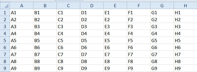

      Reference Sheet (Your Stock Sheet)
      44481-zeddyReference
      One of your 1000
      44482-zeddybefore

      Result:
      44483-zeddyafter
      Test File: 44484-ZeddyChgFormulas-RG1

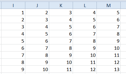

      Columns added for range test:
      44488-ColumnsAdded

      44485-zeddybefore
      After:
      44486-zeddyafter
