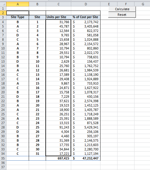

    • #1524012
      Meleia,
      Here is a vba solution. Click the Calculate button and the Percent of Cost Per Site will be calculated.
      HTH,
      Maud
      41783-Meleia
      Place in a Standard Module:

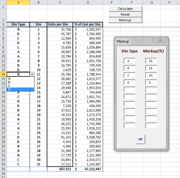

      Meleia,
      I did not see you questions in post#9, apologies! The following revision addresses them.
      1. Clicking on the Markup Button will open a form and allow you to add or remove up to 10 Site Types.
      2. I added data validation so you must select a correct Site Type.
      3. Data validation is dynamic in that the list will grow or shrink with the number of Site Types.
      4. The table will automatically update when changes are made to columns A or C. I left the calculation button in place in case you clear the resulted % of Cost per Site values (Col D).
      5. Both a Site Type and Units per Site must be populated for the update to occur (one or the other cannot be left blank)
      HTH,
      Maud
      41843-Meleia3
