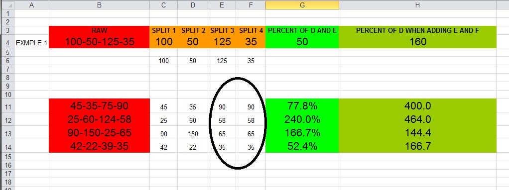

    In the provided spreadsheet, Column B4 is a piece of data in it’s “raw” form.
    In Cell Range C4 to F4 is the example if there was a folrmula to split what’s in B4
    What is the Formula to split so it appears as I have shown please?
    I have already done my percent formula in G4 to claculate the percent of D4 and C4.
    And in H4 I add E4 and F4 then it’s the percentage of C4.
    I would like those checked please if it’s the correct formula to.

        See attached file.
        I used custom functions.
        So its a bit of vba and sheet formulas together.
        see sample rows 11 to 14, cells in column [C] to [F]
        In my version, as data in column changes, the formulas will adjust automatically, rather than having to process the whole sheet.
        Now, as long as the data in column is as described, my functions are nice and simple and easy to understand.
        And blimey, my formula for column [E] entries is a little shorter than the formula used in cell [E6].
        zeddy

        Thanks all,
        I’ll try them all and let know with another sample because this becomes part of a “bigger picture”.

      • #1382003
        RetiredGeek and rory,
        I have put both macro in the same workbook for testing, plus I added some “Reset”
        conveniences for testing the project.
        I get errors in the formula after the macro is Run, if there are 0’s ( zero’s).
        I haven’t tested the other replies yet, but will do so.
        And later on I do have a piece of macro somewhere, but in Column B3 to B32, if there is a 0, I will need
        to delete that entire row.
        Thanks all for your help so far.
        PS
        There will be another thread started once this part of the process is sorted, more formula to convert
        Column H to decimal and fractions in a certain way.
        Or do I keep the same project on this thread?

    • #1382128
      rory, the formula is fine.
      Only Cell C4 has the issue… Even when I tried deleting all columns C to H,
      Then I deleted Sheet2 and, Inserted a brand new Sheet.
      Cell C4 has a problem no matter what Format I tried.
      After the macro is Run, if I type in the same number in Cell C4, it’s corrects itself.
      The #VALUE! becomes the calculation, in this case, 3.85
      It goes from 26 to 26.00 when 26 is typed, only that cell. !!
      This is not what I initially posting about, it’s a new problem.
    • #1382152
      There’s a space in front of the text in C4 – that’s what causes the problem.
    • #1382162
      Hi
      Cell [c6] in your file is a text value.
      what about my version in your testing then???
      see attached file.
      zeddy
