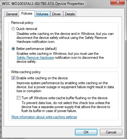

      One other simple thing to take a look at too…
      31567-Untitled
      In Device Manager, take a closer look at the disks in question and ensure they are checked off
      for “Better Performance”, as opposed to quick removal.
      “Better performance” should be a default setting, but…
      • #1342803
        31567-Untitled
        Wouldn’t that be doing the opposite of what the OP was wanting. He doesn’t want the disks to show in the “safely remove hardware”
