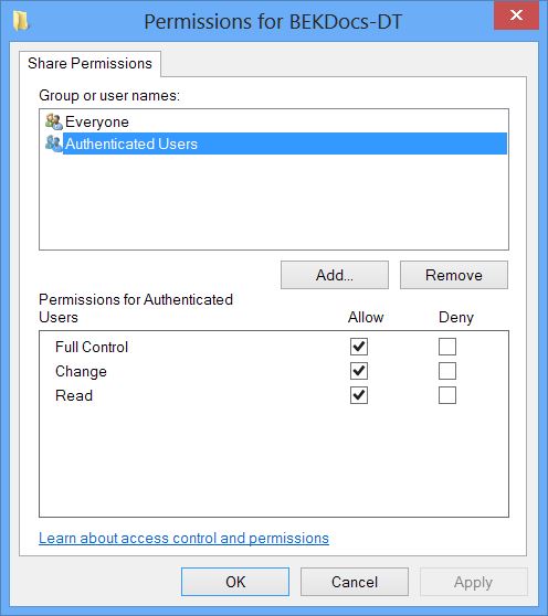

AskWoody_MVPApril 7, 2013 at 11:51 am #1385934Tony,
Homegroups will not work with XP. My recommendation is that you exit the homegroup and use standard sharing methods that work across all versions of windows. The easiest way I know is to create IDENTICAL accounts {User Name and Password} on every machine.
Then set your shares to Authenticated Users and things will work just fine.On the Sharing Tab of the Drive/Folder properties of the object you want to share click the Advanced Sharing… tab.
33622-Sharing-Tab
On the Advanced Sharing dialog click the Permissions button.
On the Permissions dialog click the Add button .
On the Select Users or Groups dialog click the Advanced button.
On the next screen click the Find Now button.
From the list displayed in the Search results box Click on Authenticated Users.
Click the OK button.
Click the OK button again.
Click on Authenticated Users in the Group or user names: box.
33623-Permissions
In the Permissions box check the permissions you wish to allow others to have.
Click Apply
Click OK.
Done. -

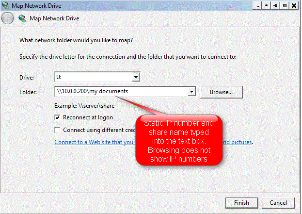

AskWoody LoungerApril 11, 2013 at 7:36 am #1386874I have found that that using IP numbers instead of computer names sometimes gets around situations where one cannot otherwise share files. I have no idea why this works and welcome an explanation for this.
In order to use IP numbers, you have to assign static IP’s to each machine and then type the share name into the dialogue box instead of browsing for the share when mapping a drive.
33670-Mapping-with-IP-numbers
