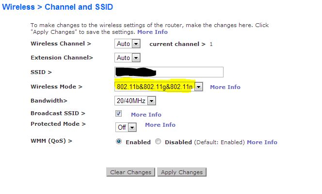

      I have a Belkin N+, so I am guessing the configuration pages should be pretty similar. In the wireless section, there is a link to Channel and SSID, which looks like below:
      32517-Capture
      I am thinking you can choose the wireless mode and set it to something similar to mine.
      HTH
