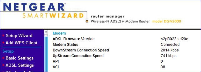

    • #1361328
      I always thought looking at your router status was the easiest way to find your speeds.
      32540-RR

    • #1361417
      RR, the image you posted was of your DSL Modem’s connection status as part of your DSL combination modem/router. I believe that the downstreamconnection figure supplied is what your ISP provisioned you for as a maximum speed, not what you are actually getting.
      Jerry
      • #1361634
        Jerry
        Very true Jerry, I use it to compare downloading speed usually using Utorrent.
