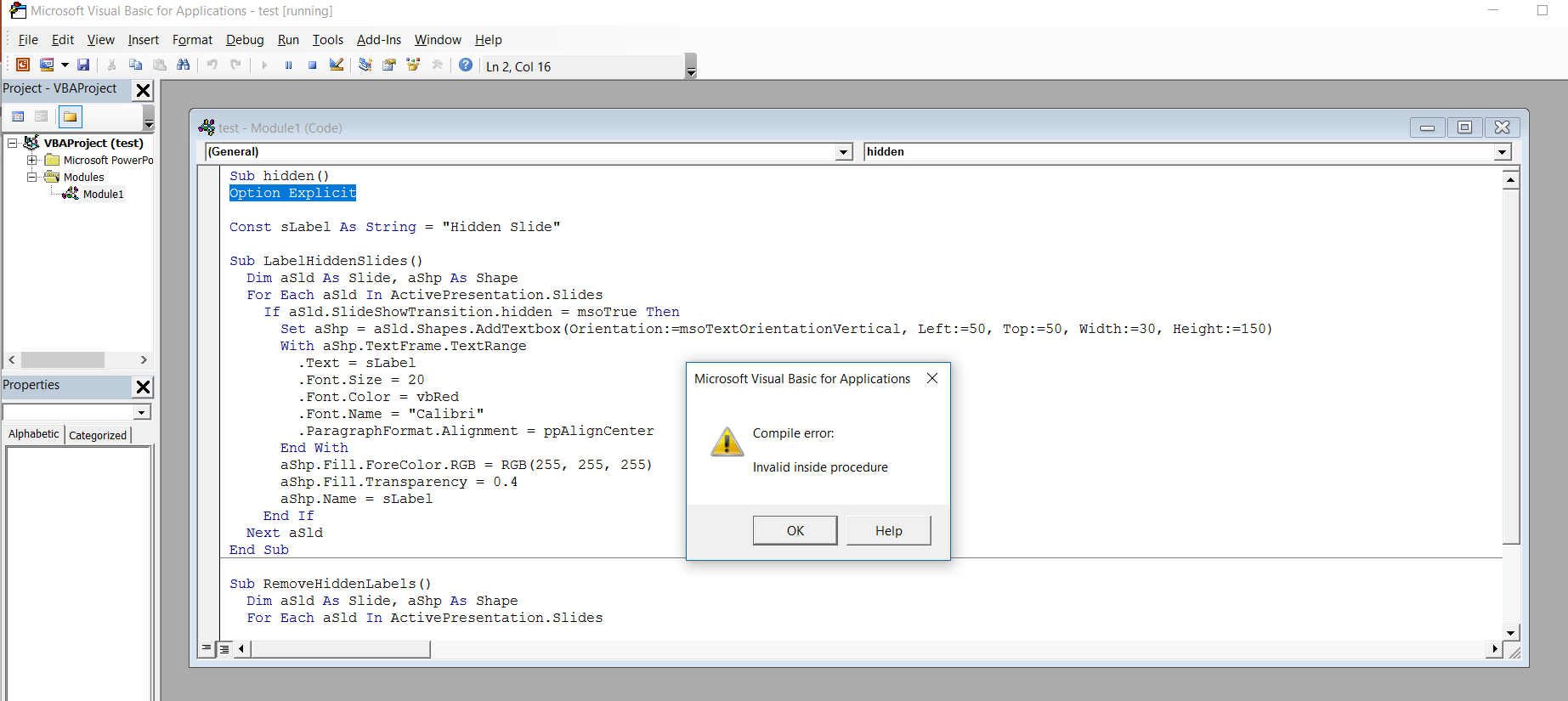

AskWoody PlusOctober 13, 2016 at 12:32 pm #1581360Thanks, Andrew. Much appreciated. So sorry for the delay.
I tried just creating and this running this macro, but got an error, a screenshot of which I’m attaching.
At this point, I feel like a fool and a j*** — a fool for asking a question that involves so much labor, and a j*** for taking so long to reply, and then complaining it doesn’t work.
If you’re up for further troubleshooting, I’d be in your debt. Of course, if you’re not, I totally understand.
Thanks so much.
Andrew Lockton
AskWoody_MVPOctober 13, 2016 at 4:32 pm #1581383Jon
Delete the first line which shouldn’t be there (and wasn’t in the code I posted).The first line of the module should be
Option ExplicitCheck through the rest of the code to ensure there isn’t any other remnants that you might have had in the module where you pasted my code. Typically the vba editor creates an End Sub line automatically when a sub is created so there could be an extra one in your code somewhere.
