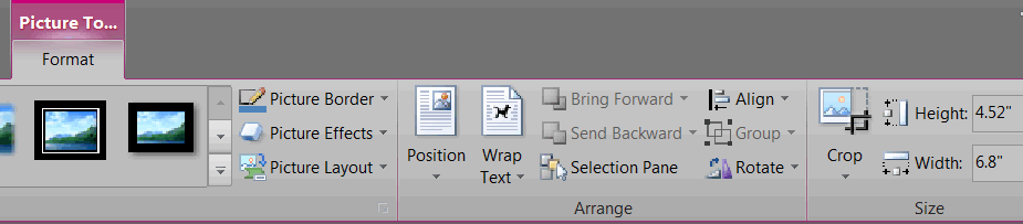

I am having ongoing issues on multiple different machines (work and home) with resizing images. The problems appear to be random … in that 1) sometimes resizing works and sometimes it doesn’t work and 2) in the same editing session images that resized “a minute ago” will not resize.
Overall:
[*]Resize always works when the picture/image handles are used (drag and drop)
[*]Double clicking an image and using the ribbon or selecting the image and then Picture Tools tab/Size group in the ribbon, and then selecting a (say 4”) width or height works randomly. [/SIZE][/FONT]
[*]More often than not the image ignores the entered data and stays the same width.
[*]Neither manually typing (e.g., a width of 4”) or using the increment arrows works.
[*]Sometimes one entry (e.g., width will be accepted) and then both width and height are disabled.
[*]Pictures from the web and from my computer all exhibit this problem randomly
[*]If a picture will not resize using the Size group in the ribbon, right clicking the picture/image and selecting Size and Position and changing the picture/image size seems to reset Word so all images can be resized. Unfortunately, after a random period Word “resets” to the non-working variation and the right-click option has to be exercised again to “reset” Word.
[/LIST]
I know other people on the web (and in person) are having this problem but no solution has been found for this “feature” – well at least I cannot find a solution.
This problem can be found in a newly created document or a new image inserted into an existing document … but as I indicated, it is random. So sometimes it works and sometimes it doesn’t.
The documents and pictures/images are not protected that I am aware of.
At least one person has indicated that reinstalling Word did not correct the issue … but I don’t think that anyone will be surprised at that.
Can anyone help with why the Picture Tools tab/Size group [/SIZE][/B]does not work consistently? Do we have a better (non-random) workaround for the problem?
