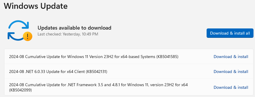

          I don’t see a Check for updates button on the Windows Update page, only a Download button.
          The reason you are seeing a Download button is that WU has refreshed itself, has found an update waiting in the queue, and is following the GP=2 setting by presenting a Download button to you. That update is waiting to be downloaded because you did not hide it in time or did not know that it was coming down the pike or you purposely unhid it. You should see the name(s) of the update(s) waiting for you to download/install.
          If you don’t want to download/install it/them, go to WUSHOWHIDE and hide it/them, then wait for WU to refresh itself, after which the Download button will disappear and the Check for updates button will replace it.
          If you DO want to install it/them, then go ahead and click on the Download button.
          As said elsewhere, do not click on Check for updates unless you know what’s in the queue because you are not checking: ‘Check for updates’ really means ‘Install updates’ — whatever they are –there is never a Download button after you click on Check for updates because you’ve given it free rein to do its thing.

          With GPEDIT=2, you will get the Download button when WU has refreshed itself and has found an update waiting in the queue.
          There will be an update waiting in the queue, if:
          1. You have unhidden an update, WU has refreshed itself, (and has found it there in the queue).
          2. MS has delivered one or more updates and you did nothing to hide it/them (or you did not hide it/them in time–in which case they will hidden in the NEXT refresh).

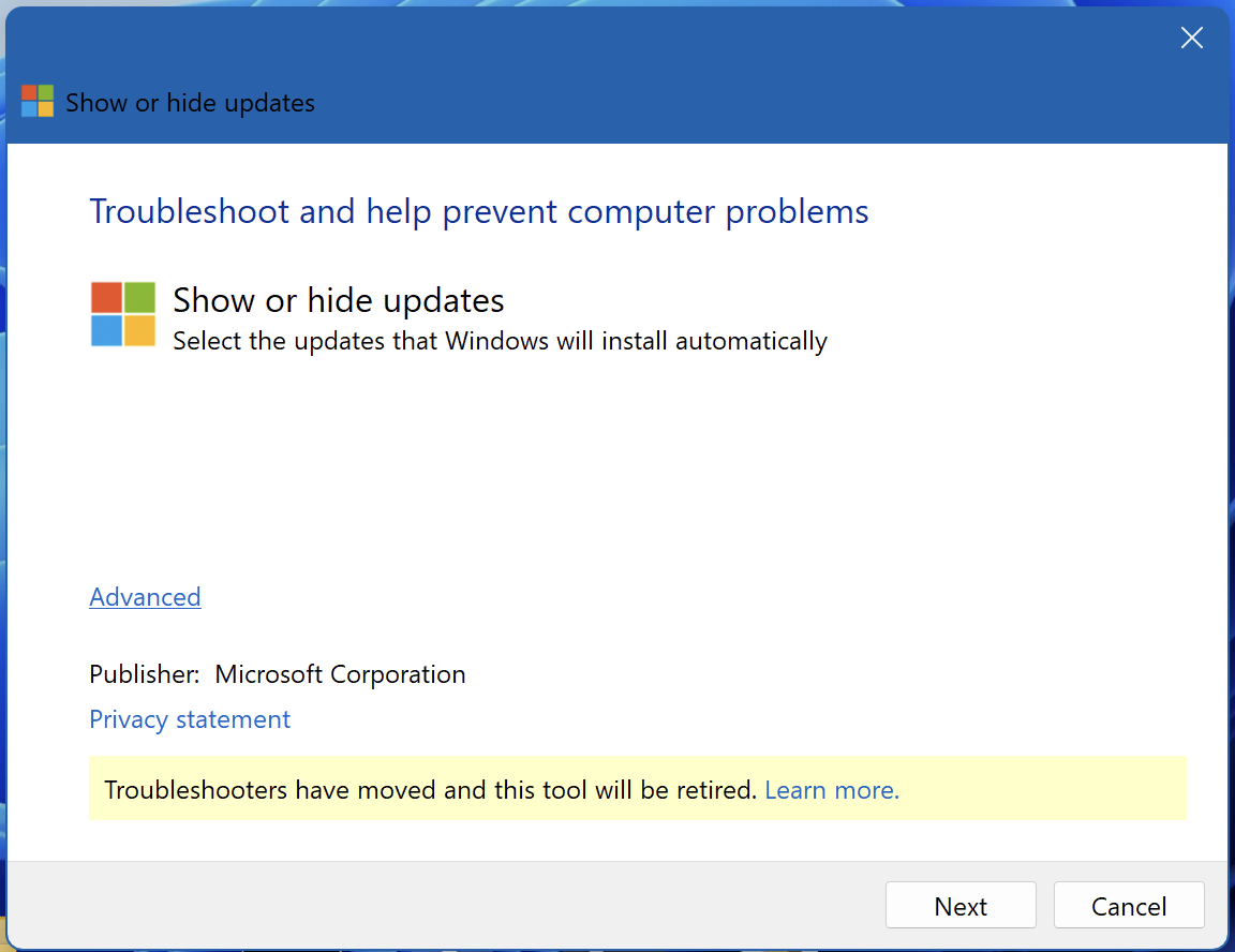

    • #2696891
      Also, the warning about retirement is not present when it runs.
      Didn’t really pay attention to that particular detail but you’re right!
      As my above screenshot shows, I didn’t get it either.
      Wonder if that’s related to which version of Windows it’s being used with?
        Windows 10 = no retirement alert.
        Windows 11 = retirement alert.
      Or maybe which version of wushowhide.diagcab is being used?
      I downloaded mine on 12/17/19 but all the files inside it are date stamped 06/15/15.

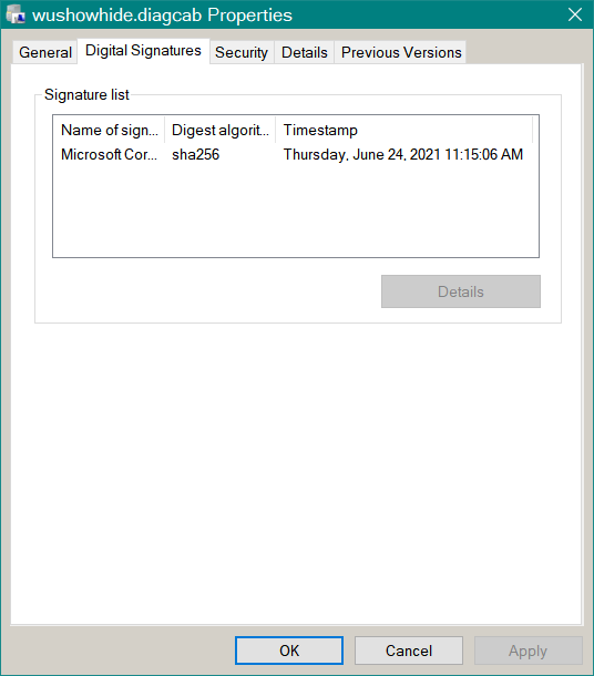

      • #2696920
        Are you using the newer version of wushowhide that Microsoft reissued using SHA256?
        wushowhide256
    • #2696947
      Yep!
      WushowhideSignature
      Same here
      DiagcabContents
      BTW, you can determine the date stamp of the files it contains by temporarily changing the extension to .zip and view it as a compressed folder.
      Once done, change the extension back to .diagcab to run it.
      Can’t duplicate the .zip method for some reason, but mine’s Win 11 and matches @EricB ‘s screenshot above, and I am seeing the retirement warning.

          Both @EricB and I are using the newer version with the sha256 cert signed in 2021 and neither of us are seeing the Retirement notice.
          Since you indicated you’re using the same version, it seems that notice is only for Windows 11 users.
          • #2697438
            I can confirm that the notice does not show on my Win10.
            Win11 only Notice.
            wushowhide-Properties
            Win11-Notice
            • #2697521
              Now, one final question about this pending retirement of wushowhide for those running Windows 11. In PK’s (and @Felix ‘s) screenshots, at the end of the yellow highlighting at the bottom of the window is a blue colored link that says “Learn more”.
              Just where does this link lead to, which webpage? Is it possible to click the link and then copy/paste the resulting URL from your browser to a post here for us to see?

              PK just found out that using the sha1 version of wushowhide with Windows 11 was the reason in that case, and upon trying wushowhide’s sha256 version, it worked again. In your case, you’re already using the sha256 version, so the only other reason I can think of for wushowhide not working is either you’ve paused updates or your copy of it and the infrastructure it needs in order to work has been retired, just as the warning says.
              Click the “Learn more” link in the warning. That will bring up a webpage describing the retirement of the troubleshooting tools like wushowhide and the way its being done. There are timelines on that page for some of the other tools, but the info is basically the same…at a point that in some cases has yet to be determined, the troubleshooting tools like (and including) wushowhide will be retired, with some being redirected to the Get Help part of Windows 11. Wushowhide isn’t named as one of them that is being redirected.

      My version of WUSHOWHIDE.diagcab is dated 2/08/2020. The Digital Signature is ‘sha1’. When I click on the ‘Details’ button under the ‘Digital Signature’ tab, it says the files were signed Jun 15, 2015.
      WUSHOWHIDE seems to be working OK
      Evidence: I was able to hide the Aug 13 patches and they are still hidden. (BTW: I have changed my network adapter connection to IPv4 {I checked at the IPv6 Site and I have no IPv6 connection right now}. I will keep it at IPv4 until just before I do the Aug 13 patches this coming weekend, at which time I will change the network adapter connection back to IPv6). I also just checked WUSHOWHIDE and there is a Defender file in the queue, but it hasn’t shown up yet in the WU screen with a ‘download’ button, but I am almost certain it will, b/c one showed up with a ‘download’ button this morning.
      So, even though WUSHOWHIDE is working fine, are you suggesting that I find one with a ‘sha256’ digital signature. If so, where do I find the ‘sha256’ version that works with Win10 22H2 with no yellow warning?
      And more to the point, are you saying that even with this newer ‘sha256’ digital signature, WUSHOWHIDE on a Win10 22H22 might stop working in the future?
      • #2699066
        The sha256 version is available through a download link in AKB2000016 and at BlockaPatch.
        Check the version you are using by right-clicking the file, choose Properties\Digital Signatures. See screenshot above.
        The notice only shows in Win11.

              By the way, as a Win11 user, it seems that at least in my case, the sha256 version is already at least partially obsolete — it only picks up at best some updates, but definitely not all, starting about a month ago.
    • #2699094
      By the way, so what’s the plan going forward then?
      After wushowhide stops working for those ion Windows 11 23H2 and newer versions, there will be two other choices for controlling the monthly windows updates: WUMgr and Windows Update Mini Tool (WUMT). Both are available from https://blockapatch.com/, which is an offshoot site of Askwoody.
