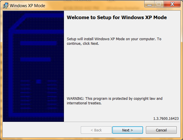

    I won’t go into the details of the kerfuffle surrounding my recent attempt to re-install XP virtual on my W7 Pro 36 bit Asus PC. I have sussefully re-installed it several times since 8-2012 with no problems. Maybe you guys can help as you’ve done before. I appreciate all your prior help.
    These are the files I downloaded:
    [INDENT]1) VALIDATOR: GenuineCheck.exe
    2) XP SOFTWARE: WindowsXPMode_en-us.exe
    3) VIRTUAL MACHINE: Windows6.1-KB958559-x86-RefreshPkg.ms[/INDENT]
    These are the steps I took to install XP Virtual:
    [INDENT]A) Go to the Windows XP Mode (http://www.microsoft.com/en-us/download/details.aspx?id=8002) webpage, select your language, and click on the Continue button
    Select your language, and click on the Download button for the version (ex: WINDOWSXPMODE_EN-US.EXE, ) you want to download.
    XP software installation:
    Download the Windows XP Mode installer.
    Double click on the installer and follow the instructions to complete the installation.
    [INDENT]Note:
    We recommend that you save a copy of the Windows XP Mode installer for future, to restore the Windows XP Mode environment. For example, you could burn the installer to DVD or save it to a backup media. If the files installed by Windows XP Mode gets corrupted or deleted, you will get an error while trying to start Windows XP Mode. You can then try reinstalling the Windows XP Mode using the installer that you have saved.
    [/INDENT]
    B) Download and Install Windows Virtual PC At the Windows Virtual PC webpage (http://www.microsoft.com/en-us/download/details.aspx?id=3702), select your language, and
    click on the Continue button. http://www.microsoft.com/en-us/download/details.aspx?id=3702
    C) Select your language, and click on the Download button for either the WINDOWS6.1-KB958559-X86-REFRESHPKG.MSU (32-BIT)
    or WindowsXPMode_en-us.exe Windows6.1-KB958559-x64-RefreshPkg.msu (64-bit) file for your same 32-bit or 64-bit Windows 7 version you have installed.
    Virtual Machine PC installation:Upgrade from Windows Virtual PC Beta to Windows
    Virtual PC RC is not supported. Click here for more information.Based on the architecture (32-bit or 64-bit) of your computer, download the appropriate update package (Windows6.1-KB958559-x86.msu or Windows6.1-KB958559-x64.msu).Double click on the update package (Windows6.1-KB958559-x86.msu or Windows6.1-KB958559-x64.msu) and follow the instructions. Reboot your system to complete installation.[/INDENT]
    Below is the ERROR I got after XP Virt after a re-boot of XP virtual that was up & running.
    cheers,
    klx

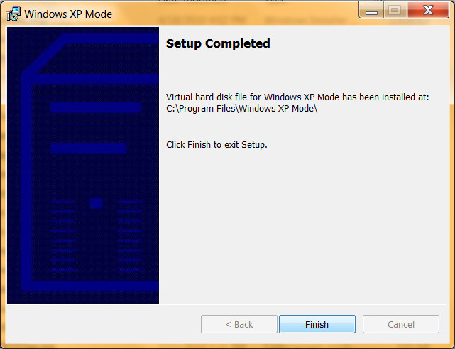

      • #1438971
        Joe,
        From a clean PC, I followed the steps at Ms to no avail. These images should tell you the story as I have gotten the same reslts several tims in the last wk trying to re-install XP virt:
        Must be something else going on however; my W7 portion is running fine.
        cheers & thanks,
        klx
