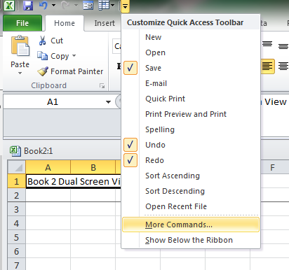

      To add them to the Quick Access Toolbar (QAT),
      1. Click on the arrow to the right on the QAT and select More Commands…
      2. In the Customize the QAT window, select Macros from the “Choose Commands From:” drop down box.
      3. in the selection window, select the macro then click the Add button
      4. repeat for the second macro
      5. Click OK
      35941-ScreenView3
