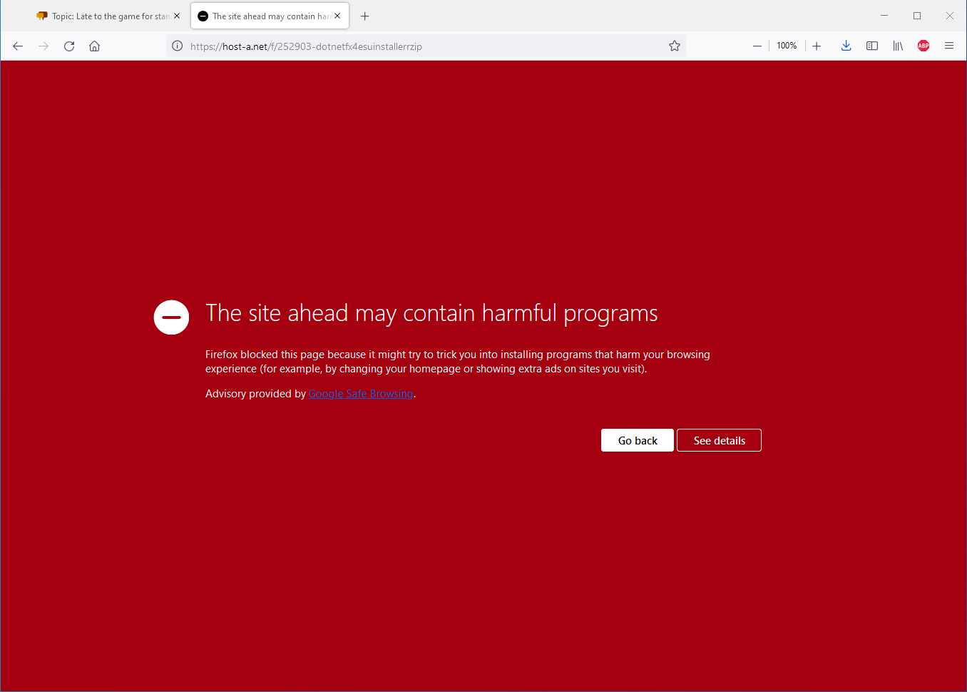

      I started to download the needed scripts and was stopped cold by a Firefox warning when I clicked on the link for the .Net related script.  As you can imagine, I did not proceed and would prefer to obtain the .Net related script from a different source.   Is that possible?  This is what Firefox displayed –
      blocked
      • #2378258
        Standby. I will contact @abbodi86 and get back with you.
        I get the same warning in FF90.
    • #2378289
      OK, try again.

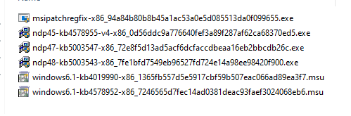

      For the .Net Framework it seems I have various versions installed — 3.5 SP1, 4.62, 4.7, 4.71, 4.72 and 4.8.  So I downloaded the KB5003779 rollup but I am not sure if I should attempt to use the dotnet script to install all of the items.  Following are the rollup contents –
      dotnet5003779
      My understanding of the process is that I do not need to install :
      msipatchregfix-x86_94a84b80b8b45a1ac53a0e5d085513da0f099655.exe
      ndp45-kb4578955-v4-x86_0d56ddc9a776640fef3a89f287af62ca68370ed5.exe
      windows6.1-kb4019990-x86_1365fb557d5e5917cbf59b507eac066ad89ea3f7.msu.  Already installed Windows Update.
      Should I proceed as described?

        Make two folders, one for the OS updates and one for the .NET updates, with the scripts for each included in the associated folder. .NET 3.5 updates need to go in the OS folder using W7ESUI. The .NET 4.x updates go in the .NET folder with dotNetFx4_ESU_Installer_r.
        The Rollup is not a single file. In the Catalog, when you click to download the Rollup, you will see the individual version updates. You only need the ones for your version(s) – 47 and 48 since 3.5 is already installed.

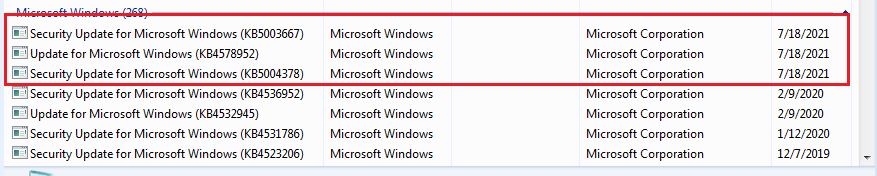

              Should the August 2020 SSU be installed separately or can it be combined with the June 2021 rollup?
              I’m very confused now.  Before you responded above I ran a test and used the script to install the July 2021 SSU along with the June 2021 Win7 rollup and the .Net 3.5 rollup.  The script completed without error and update installation appeared to proceed normally when restarting the system.  These items appeared as installed updates –
              Win7JulySSU
              So all appears ok regarding Win7.   Am I missing something here?
            • #2378456
              It has to be installed before the others will install. It is a prereq. Install it first, alone in the folder.
              Then you can put the July SSU in with the June Rollup if you want to install it.
