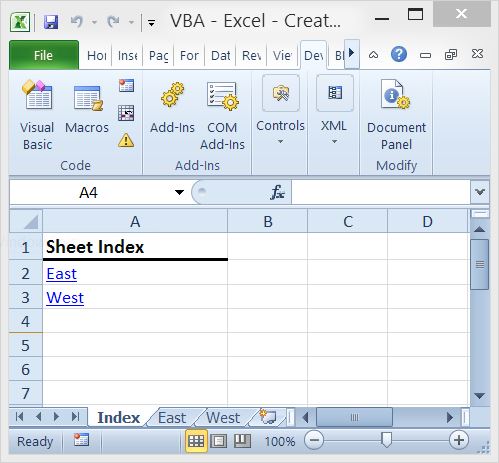

I would like a macro to create an index sheet that updates when new sheets are added or deleted

AskWoody_MVPNovember 6, 2013 at 7:50 am #1421464Howard,
Here’s one possible solution:
Code:Option Explicit Private Sub Worksheet_Activate() Dim sht As Worksheet Dim lCurRow As Long lCurRow = 2 For Each sht In ActiveWorkbook.Sheets If sht.Name "Index" Then Cells(lCurRow, 1).Select ActiveSheet.Hyperlinks.Add Anchor:=Selection, Address:="", SubAddress:= _ sht.Name & "!A1", TextToDisplay:=sht.Name lCurRow = lCurRow + 1 End If Next sht '*** Clear out any deleted sheets *** Cells(lCurRow, 1).Select Range(Selection, Selection.End(xlDown)).Delete Shift:=xlUp End Sub
35367-Excel-index
Note that the code goes in the Index Sheet module. See attached sample file. The index is automatically recreated every time the Index sheet is selected.
35368-VBA-Excel-Create-Index-sheet

HTH :cheers:Works great, just note that sheet names must not have spaces or dashes. Apparently, these special characters break the code.

AskWoody_MVPNovember 7, 2013 at 6:41 am #1421663Maud,
Actually the code will work where ever the Index sheet is located as long as it is named Index. Of course the Index sheet will NOT show up in the Index. I has assumed (oh that nasty word :lol:) the idea was to get to the sheets quickly thus the hyperlinks. :cheers:

AskWoody_MVPNovember 7, 2013 at 8:54 am #1421688Assuming the Index sheet is the first sheet
RG,
I was referring to the code I posted. It must be in the Worksheet_Activate event subroutine of the first sheet, Worksheet(1), so that the code will display Worksheet(2) and Worksheet(3) as I cycles from 2 to the number of sheets.

AskWoody_MVPNovember 10, 2013 at 6:44 am #1422064Steve,
Thanks for updating this. I never put spaces in sheet names, a habit developed decades ago, so I keep forgetting about this requirement when I write code. I’ll see if I can cram one more thing into this old cranium as it is always good practice to allow for all possibilities. Thanks again! :cheers:
WSsdckapr
AskWoody LoungerNovember 10, 2013 at 7:11 am #1422069FYI, without the spaces the single quotes are NOT required but in cases like this it does NOT hurt to add them if not required. using them in INDIRECT , HYPERLINK. etc formulas around the sheet name will not hurt if they are not required (XL will remove them) but are neccessary when required and it is a good habit to just use them even if the names do not require them.
