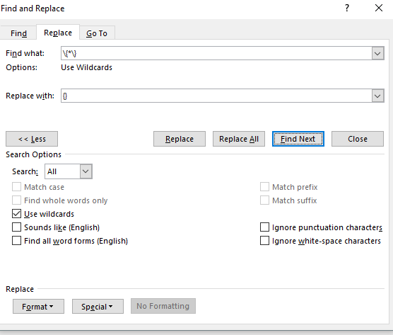

AskWoody MVPMarch 9, 2017 at 8:01 am #1593045I’ve just done a test on your Word Doc. On the Replace tab of find, click on more , then click on Use wildcards. The strings I entered are on the attachment. What you replace it with is up to you (you say words within the curly braces). Leave the replace field blank to replace the string with, well nothing.
The back slashes are required because { and } are special characters
