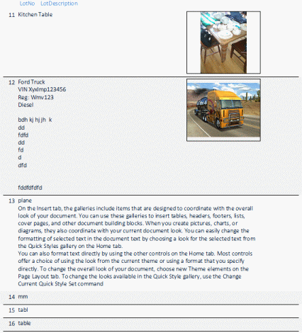

      I don’t know where it comes from. I have mocked up a report with images, and in my report the extra space is inside the image, when the image is landscape.
      If I put a border around the image then the Detail section of the report finishes at the bottom of the border.
      But I have now put a lot more text into the memo field and I can see the problem.
      I am not sure, but I think Access just gets confused about how much space to allocate to the memo. As it grows to accommodate the text it grows too far.
      I will keep looking.

    • #1325226
      Actually I do have another suggestion.
      Instead of changing the Height of the picture in code:
      Me!UM_Pic.Height = 0
      Me!UM_Pic.Height = 2 * 1440
      Just change its visibility
      Me!UM_Pic.visible = False
      Me!UM_Pic.Visible = True
      and just leave the Height permanently at whatever you want it to be.
      I don’t know why this should work, but I did make this change in my code.
      Initially it did not help, but the report then worked properly when I added the FormatCount code.

      • #1325406
        The downside is without reducing the height on the picture control when there is no picture every detail line is at least the height of the picture control even when the text requires less than the 2 inch setting.
        Hmm. That is not happening for me. Is the Can Shrink property of both the Detail Section and the Memo field set to yes?
        30396-IllustratedCatalogue
