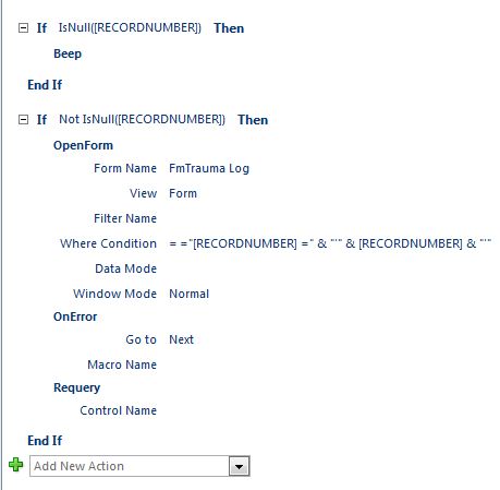

        I looked at the Tasks template and after much head scratching and searching found I had to do the following, which I elucidate for the benefit of others, to my Report (in Design mode):
          [*]Select the Textbox on the Report that references the unique ID of the record to be opened in Form view
          [*]Set the Textbox Format Property “Display as Hyperlink” to “Screen Only”
          [*]Select the Textbox Event Property “On Click” and click on “…”
          [*]Open the Macro Builder and build a macro in the following form:
          29768-20120110-Macro-for-jumping-from-a-Report-to-a-Form
          [*]Save the macro and close Macro Builder
          [*]Save the changes to the Report
          [*]Open the Report in Report (on screen display) mode
          [*]The record identifier will be highlighted as a Hyperlink and when clicked should open the appropriate Form at the selected Record.
        At least that worked for me.

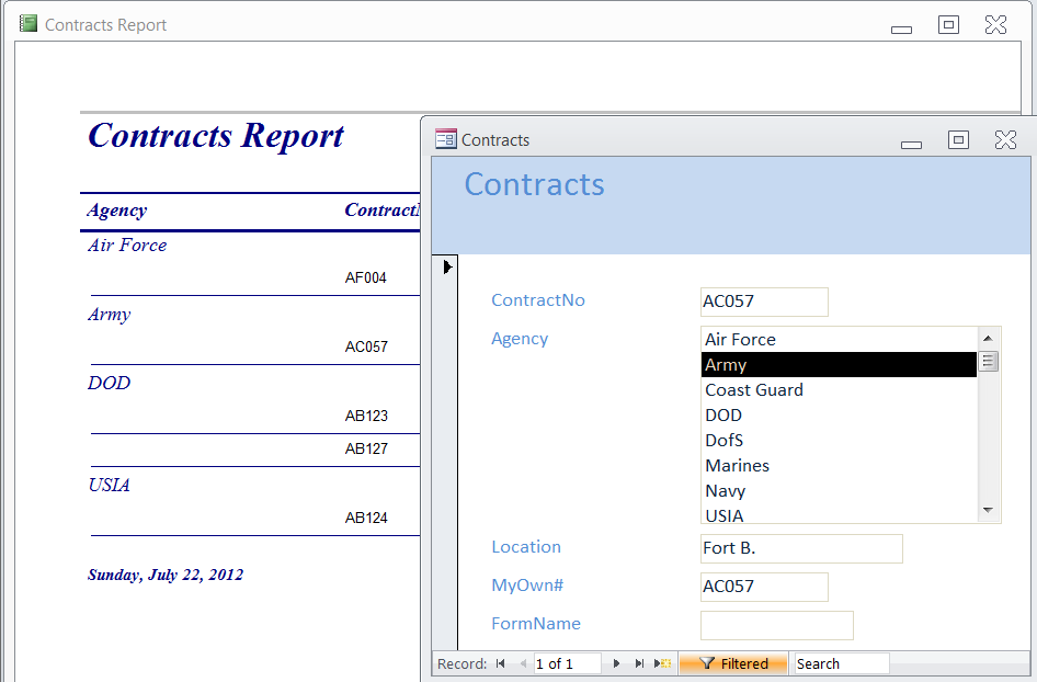

      You can do this with a regular report by using the Click event on the ID field with code like this:
      Code:
      Private Sub ContractNo_Click()
                 DoCmd.OpenForm "Contracts", acNormal, , "ContractNo = " & _
                            Chr(34) & Me.ContractNo & Chr(34)
      End Sub
      Note: the Chr(34)’s are only necessary if the ID value is a string type.:cheers:

          I have created from scratch using MS Access 2010 the attached zipped database (20121129 TEST Report Form Linking.accdb) which I believe, from the limited information you’ve provided, replicates your situation.
          The steps I followed were:
          [/FONT][/FONT][/COLOR]
          [*]Create a Table called “Patient Data” with two fields: “RECORDNUMBER” and “Patient_Data”
          [/FONT][/SIZE]
          [*]Create a Form called “FmTrauma Log” with all fields from the “Patient Data” Table
          [*]Create a Table called “Rpt Quick View List” with all fields from the “Patient Data” Table
          [*]Using the instructions contained in my post dated 2012-01-10, 11:51 the Report Recordnumber field was hyperlinked to the Form
          [*]Open the “Rpt Quick View List” in Report View mode (NOT Print Preview mode)
          [*]Click on a Recordnumber
          [*]Form FmTrauma Log opens at the selected patient’s record — It worked without error messages.
          [/LIST][/FONT][/COLOR]

        I have revised my sample database such that RECORDNUMBER is now a unique Text field and it works – in Access 2010 – a copy is attached. I had to slightly modify the macro code to prevent an error because the RECORDNUMBER is now text, and in my example with a space in some of the record identifiers. Here is the revised macro code:
        32489-20121128-Hyperlink-Macro-Code
        Note that line:
        [INDENT]Where Condition = = “[RECORDNUMBER] =” & “‘” & [RECORDNUMBER] & “‘”[/INDENT]
        In this line use double quote (“), single quote(‘) double quote(“) around the second instance of [RECORDNUMBER] as shown above.
        Hope this helps.
        Cheers
        BygAuldByrd
