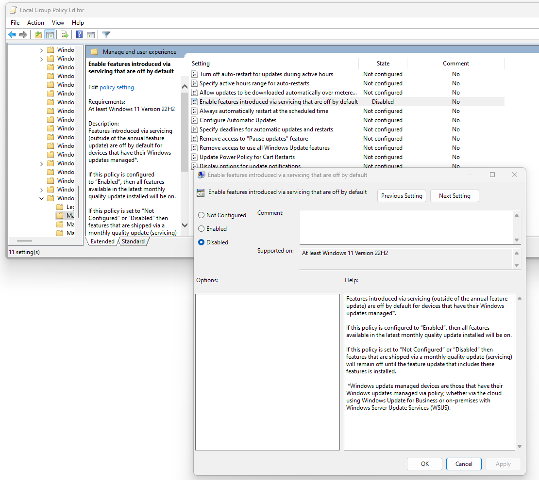

        Pro or Home?  And honestly in my testing I haven’t found the “gate” that Microsoft provides to hold back much.  Fortunately most of the “moments” have been either minor or ‘eh’ sort of things.
        • #2569773
          Sorry, I should have mentioned Windows 11 Pro.  Thanks.
          How can I block it?
          Mark
          • #2569811
            grouppolinfo
            Look for this in group policy
            • #2569897
