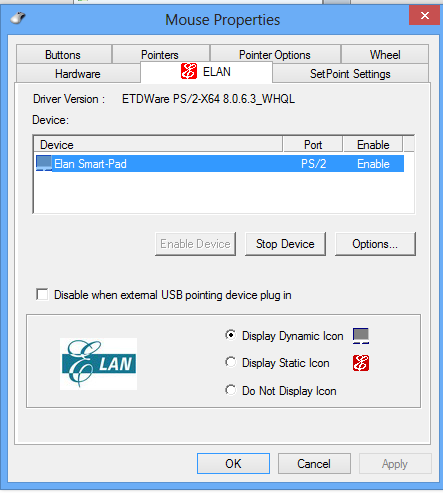

AskWoody LoungerJune 2, 2013 at 6:08 pm #1395067Disable the touch pad, by all means, as previously described;
Do NOT disable the so-called left and right buttons, though;
If you hit a BSOD, sudden shutdown, or improper reboot, your USB wireless mouse may not work, so you have to have a way of inputing, unless you want to rely on keyboard only, unless that’s USB, too.another option, depending on the touch pad software, is to select disable when USB mouse is present. By using this option if anything were to fail on the USB mouse, simply remove the receiver from the USB port and the touch pad will be restores to use and that can come in handy. Here is a snap shot of my touch pad features by right clicking the system tray icon of the touch pad and you can see the option to check to disable the touch pad just below center of the shot,
