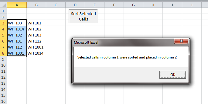

    • #1540610
      bhdavis,
      Here is a VBA approach. Select the cells in the column you wish to sort then click the Sort button. The values will be sorted according to the number segment of the value. The code assumes that there is a space between the prefix and the number. The code works by splitting the value between prefix and number, assigning them to a two dimensional array, sorting them, then rewriting them back to the sheet. Note: You can select any contiguous or non-contiguous block as long as they are in the same column. You can also set the destination column to either write the sort to a new column or overwrite the existing values (change value in code line indicated in blue). The number of rows is unlimited. I have supplied the workbook in Excel 2003 and 2007+ formats for those who are interested
      HTH,
      Maud
      42818-bhdavis

      • #1540646
        Thank you for this as well. The column split with “Text to columns” seemed like it might be a bit less complicated so I took that route. I really do appreciate your time in laying it out this way though. Something to be learned.
        BH
