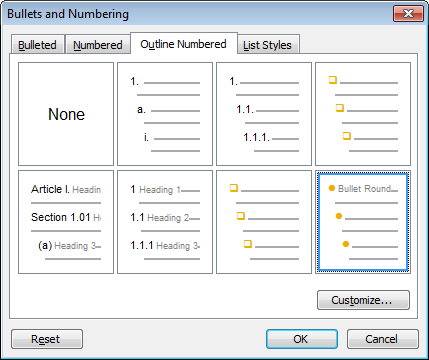

      First create a paragraph style and set the bullet in the Bulleted tab.
      30739-WordList1

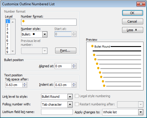

      Then click the Outline Numbered Tab and do not change focus from the highlighted square
      30740-WordList2
      Customise that as required.
      30741-WordList3
      Result. I can indent as many times as I want.
      30742-WordList4
      This method allows me to have multiple bullet styles that all indent properly.
