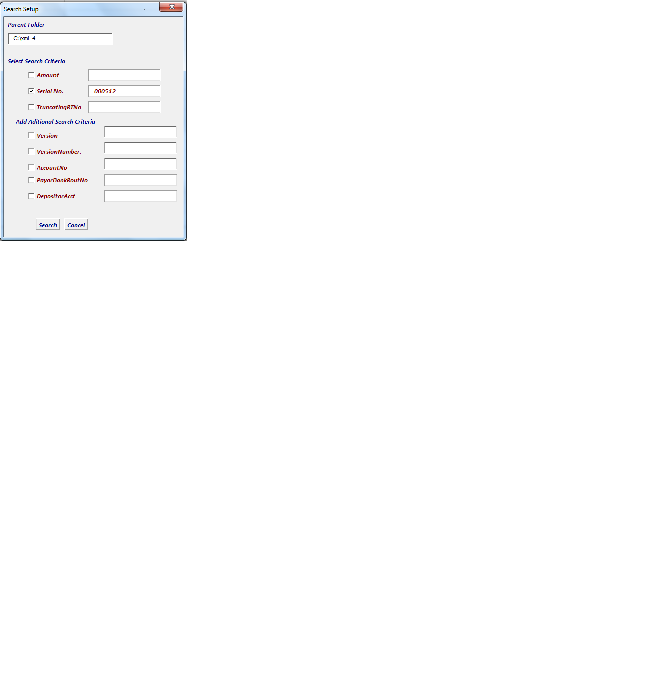

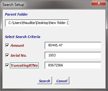

      Here is a workbook that you can use to manage your entire database. It will search a parent folder and subfolders for xml files. Once found, the code will display the file path, file name, file size, and Last modified. Under each display it will perform a search for the three parameters you requested and display their values. You also have the option to search for an additional 5 parameters if you so desire. In the following image, I have added additional search parameters.
      35085-files
      At the beginning of each search, a search setup dialogue box will appear and allow you to set the default parent folder, select or deselect the 3 default parameters, and add an additional 5. Please see the attached images. The code will remember your settings and you can have an unlimited number of files and/or sub folder levels.
      35083-Setup-files
      If you decide that you want to use it, let PM me and I will help you integrate it into your project , otherwise, it is ready to go!

      Maud, I need a small change if its possible, when a particular search is given it display the search result is it possible to display the other details of that tag. If like suppose search for SerialNo= ‘000512’ it will also display the Amount, ItemSeqNo,PresentingBankRoutNo,AccountNo in the descending rows.
    • #1419509
      fjohan,
      Here is the revision. The matches for the criteria that you select (image #1) will be displayed along with the additional info you requested from the matched files as well. The criteria that matched will be bolded (image #2).
